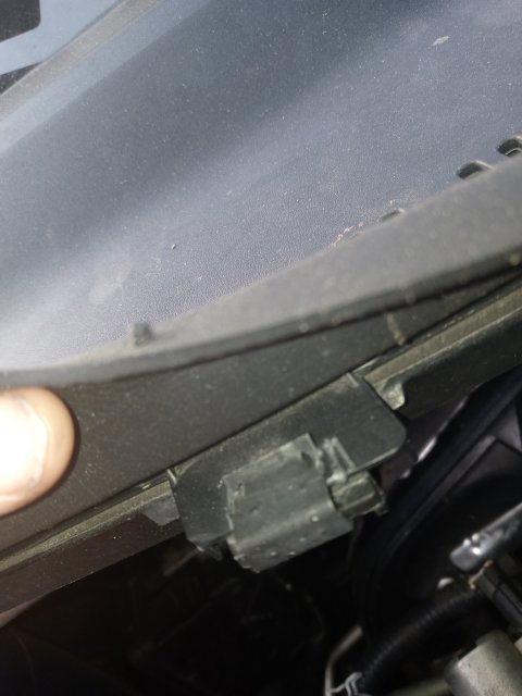

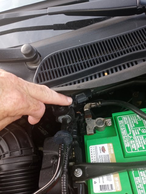

I might have a possible explanation. If you open the hood and look closely at the cowl panel at the base of the windshield, there are several metal clips that hold the leading edge of the plastic, vented panel over the wiper drive mechanism.
If one or more of those clips are missing a vibration or rattle can result. These clips hold the two sections of the cowl together that are the protective shroud for the wiper transmission and also channel water away from the engine compartment.

View attachment 5340 View attachment 5341
I mentioned that in post 2....don't know if split checked that or not.
The clips are all in good shape, no movement.
