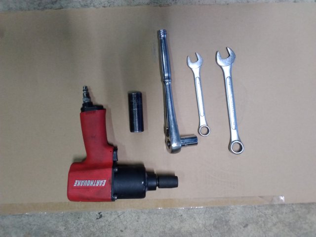

The required tools are a 15 mm socket and wrench an 18 mm wrench a floor jack and a pair of Jack stands. And a couple of 18 to 24 inch long 2X4's.
I used a hoist. But it might be easier to do with the stands and a floor jack.

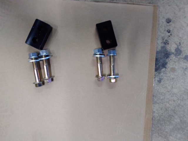

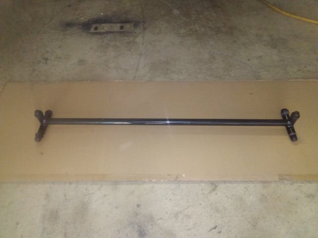

The second image is the attaching hardware.

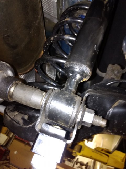

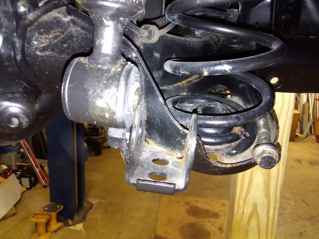

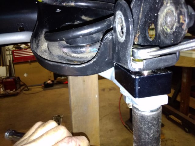

Support the chassis on stands and take the load off the axle by using the floor jack and a short 2x4 tucked into the v of the beam. Jack it enough to take the weight off the shock absorber lower bolt.

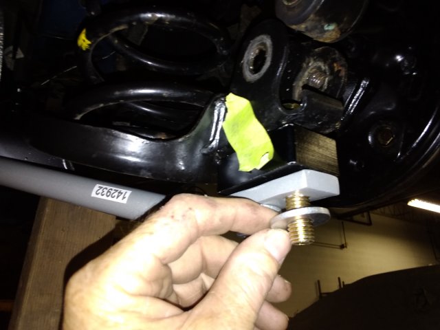

Once the bolts are dropped through the existing holes, you can put the spacers on. I was working alone, so I used a bit of masking tape to hold the spacers on while I placed the anti-sway bar into position.

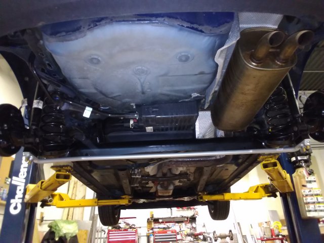

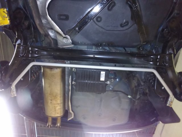

A couple of views of the completed install. This was much less hassle to install than the Eibach axle beam stiffener that I had to measure and drill four large holes through the axle beam in order to install. I am going to evaluate this piece for possible use on another Fiesta project I am working on. I don't know if I will end up needing it, but I want to have this one ready to go.
Welcome to the forum. I think the one you have is the same as the Whiteline piece. Just different powder coating color. I have a different Eibach bar.
This one is more of an internally mounted beam stiffener. It did get the job done. But required me to drill four large holes in the axle beam to mount it.
