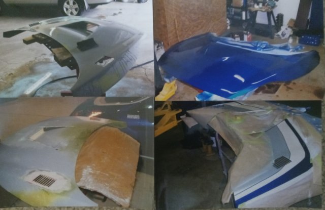

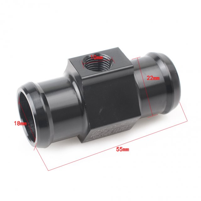

I have used an adaptor that has a threaded port machined into it for a water temperature sensor. They come in various diameter and are placed nearest to the coolant outlet of the engine cylinder head. They are generally made of aluminum and are not expensive. From less than $10 dollars to around $20 dollars, depending on the size of the adaptor. The closer to the water outlet the better. I have to add that i think this would be better in terms of providing information about engine temperature than the factory temperature sensor outputs from the factory setup. The factory temperature sensor outputs are so heavily buffered at the ECM to be almost useless as an "early warning" solution. When I was autocrossing my 2011 Fiesta, i rigged up a J type thermocouple near the coolant outlet of the cylinder head and was shocked by how quickly the the engine temps would spike during a run. The thermocouple told me that the engine temps were much higher than what the factory temperature gauge indicated! The situation was concerning enough to motivate me to create a ducted and vented hood. hfhhlminfjhiqehpfjqqmjlllmkpmmjkjhhgAGxU.jpg 20220202_181151_(1).jpg

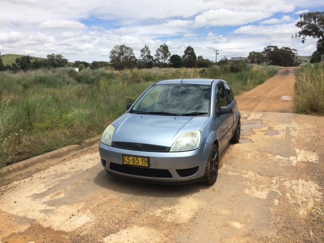

2005 Fiesta LX
2005? Nice! Welcome!
Yes, a 2005 WP. Purchased it when on holiday in Perth, Western Australia as a cheap runabout. Liked it so much I drove it back to New South Wales (3700km). Still stock standard apart from alloy wheels and some Hankook RS4 sticky tyres. I’ll have to get an ST!
