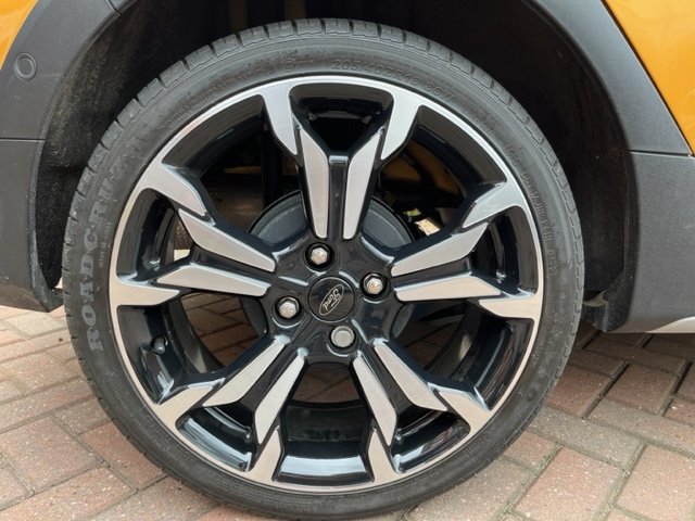

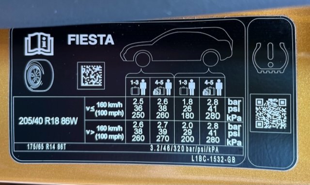

The tyre pressure sticker in the door suggests F36 R26 for the fitted 205/40 R18 tyres - BUT IT FEELS TERRIBLE WITH THESE PRESSURES!!!!
What are you guys running please?
Many thanks!

The very harsh ride quality is a side effect of the huge, heavy wheels with the very short tire sidewalls. You can’t really drop the tire pressures because you would damage your tires and create a safety hazard.
You could go to a 16 inch diameter wheel and a taller tire. The ride quality would improve dramatically.

I'd find a pressure you're willing to live with, and just run that in both sets.
Unless it's an MOT issue, you are allowed to run a pressure in those wheels to help you maintain control of the vehicle at all times and in all conditions.
