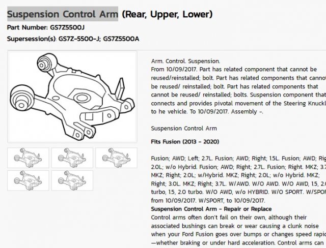

Hello, I'm trying to replace the bushing in the rear passenger side suspension control arm of a 2014 Ford Fusion SE 2.0L.
I have attached the part that needs the bushings replaced.
Does anyone know the part number I should be looking for? Is it possible to replace these bushing with the lower control arm still attached? With regular hand tools?
Thanks and best regards!
Honestly - you'd have to remove the arm in order to press out the old and press in the replacement bushings.
Best to replace the whole arm, and do both sides for best tracking and drivability alignment. (Wear issues)
