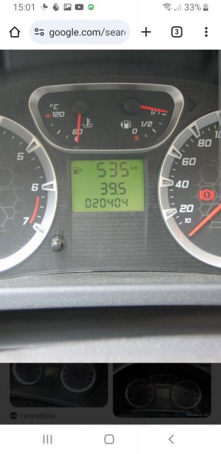

My trip computer shows how many miles in tank and current mpg and total miles like one in photo but in miles
But I can't seem to be able to reset it when I fill up to give me new reading from that moment on
Can anyone help please on procedure to rest Screenshot_20231106-150152_Chrome.jpg

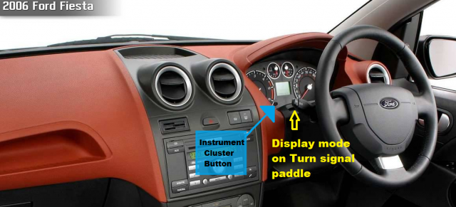

So what I'm curious about is do you have a push-button on the turn signal paddle?
I see you also have a push button on the Instrument console - so it too should also let you reset.
So you simply press the button to make the display change - the line that changes is the one the button can change by resetting - you hold it down (you press and keep it pressed) once you have the information on the line displayed - that is the ones you want to reset. Then release that button to let the system take over and do the calculations
The key has to be in - and the engine has to be running (at least the Key turned to ON (not just ACC - but ON)
