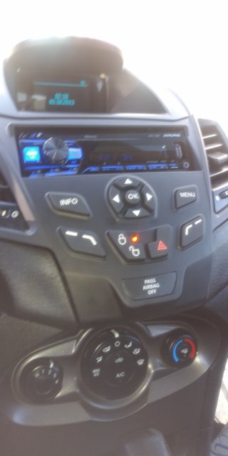

I'll go with a new head unit anyways. Id rather not have a line out converter. With head unit the little screen on top I think wont work. Which has date. Time. Ect. But that is also true that traction control is controled with that screen.

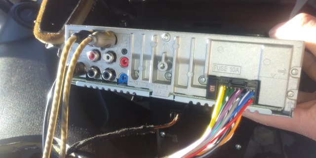

Wait that's not true.. My mistake. That will still remain and work. Theres a circet board on the back side of the trim plate that has the power button and lock and hazards. The fit kit has to have the oem board from the old one installed on the new..new radio will also fit in the new fit kit.
