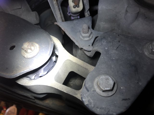

although now, i believe the sway bar bushings are NOT to blame. i was never able to replicate the sound on stilts. so i found a worn out bushing, pressed it’s housing and was shocked how much i was able to move it by hand. i usually hear this big knock when i go from a stop to first gear, as the car lurches forward. this is the bushing. not sure what it’s called but i’ll be heading back to the wrench a part when i have time to grab a replacement.

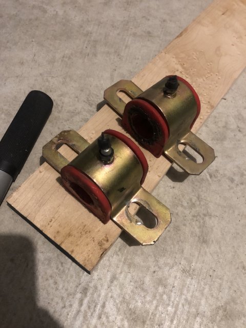

i also had an issue with the poly bushings, the 13mm flange head nuts that hold the bracket in don’t allow the nut to be fully flush with the bracket as the bushing casing is too wide.

here’s a pic of the poly bushings as well, might find some non flanged 13mm bolts and throw them back on

Will need to clarify, but was this shot taken from underneath the car?
  • And so everyone knows this was not an original diagnosis - it was a condition - but the problem lies within the bushings but from where?
Looks like the lower Motor mount - seeing the pull on it, that sag usually shows up after about 5~7 years - the rubber/urethane material - deteriorates from heat and the torque. I see the material bending-separating from the housing itself.
The Manual or Auto is why I ask? Different densities of material which affects the handling
  • IF this is the motor mount or thereof, then you may need to look into replacing all of them as time permits
Just need to know if this was on the case/engine housing or the rearward towards passenger compartment?
Good job on figuring this one out with what little you had to work with and was able to isolate it.

thanks andy!! yes, i think it’s my lower motor mount. it sits underneath and to the back of the engine underneath the car.
the car is standard transmission from 2012, sounds like it’s overdue for these motor mounts then..

dang it! should’ve taken some photos. i replaced the two motor mounts and the transmission mount, it came in a kit off rock auto. very simple job, though i broke a bolt holding the battery compartment in place but it doesn’t seem to be an issue. seemed to take care of all the clunking sounds i was hearing!

and i was able to tell easily that the mounts were worn just by pushing in the motor and observing the play in the bushings. when taken out the rubber was terribly worn. made a huge difference andy, highly recommend performing asap
