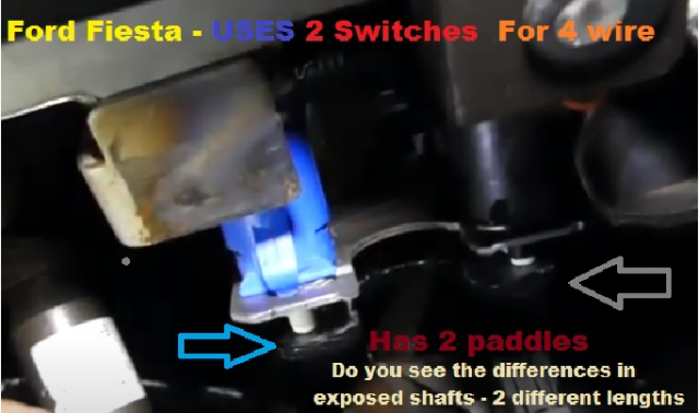

There is also a SECOND switch in this that runs off the brake pedal - so if that fell out of its socket this might cause this condition too - but to clear it - you do the same thing - get under the dash, check the switches to see if they are in their position right next to a set of "paddles" they work with when you press the brake.

Two switches, one blue one black - these are shown SEATED and the Brakes
are NOT applied - this is how it looks when the system is at rest.​
You are looking UNDER the Dash, by the Brake pedal - straight up from it right next to and under the steering wheel.
