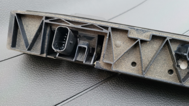

I have a '16 Focus Hatchback with an intermittent backup camera. I disassembled the hatch this afternoon to expose the wiring and popped the backup camera assembly out of the housing. I've proven to myself that the issue is a bad camera because when I bend the connector around I can get the camera to come on. It looks like rockauto has a replacement for $106... but I can't figure out how to get the camera itself out of the housing (pictured here). The replacement camera is a small cube with the connector on it... so this has to come out of this housing somehow. Any ideas?

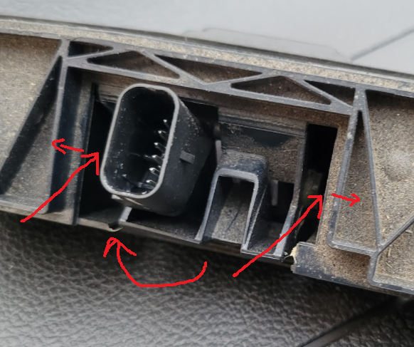

For completeness sake - here is what I found:
The camera was released from the housing by sliding a thin flat head screwdriver into the slots on the sides and pressing outward and then rotating the clip out and over the camera. The camera then just pops out and is easily replaced. Reverse all the steps to reassemble.
