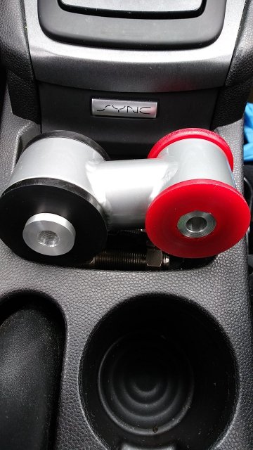

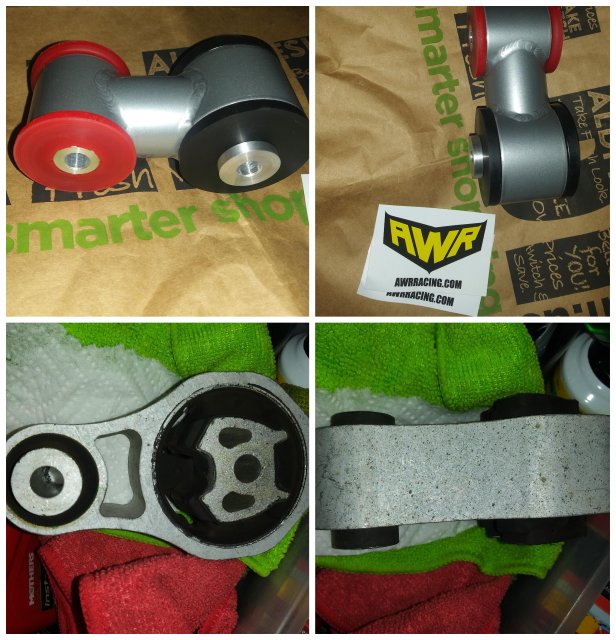

There is finally an aftermarket RMM available for the DCT equipped Fiesta! I have been driving with the prototype for one week now. I have the 70A RMM. Light acceleration and deceleration, including braking to a complete stop, is so smooth now. Heavy throttle acceleration and upshifting/downshifting is crisp. The engine is more stable throughout the entire driving experience. NVH has barely changed. There is a very slight vibration in the steering wheel and side mirror, but is barely noticeable (I have driven extensively with the AC on). Noise has remained the same, although the exhaust is already noisy so I couldn't tell any difference. Lastly, the motor mount itself is really nice looking and the welds are of great quality. I highly recommend this mod to all DCT owners out there. https://store.awrracing.com/2011-2019-1-6l-fiesta-rear-motor-mount-s-se-ses-sel-titanium-models
AWR RMM on top row and stock on bottom row.
You have the 70 durometer version. Could you get them to let you try an 88 duromter?
I also noticed that they sell a RH motor mount, also with four bushing hardness choices.
