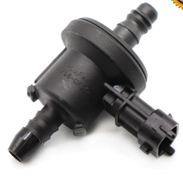

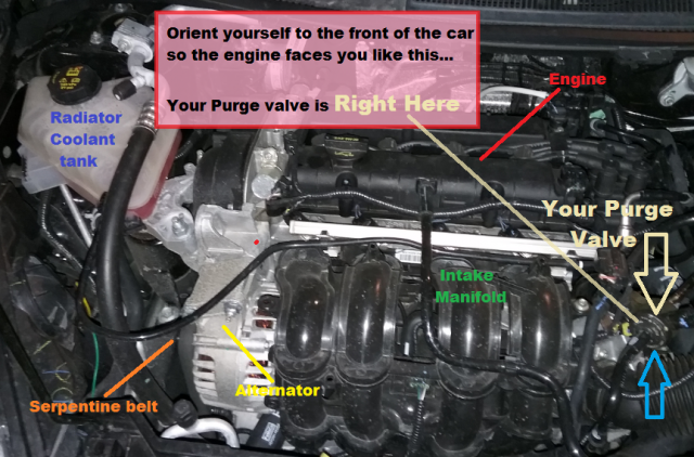

Thank you and I will check that out. In the meantime, since I already bought the part.... any idea where the thing is located? I can't find it! Lol
Oh, it's here...in the front engine compartment - right above the snorkel - you know - that ribbed hose thingy...

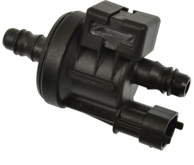

They both would work, but one has the right angle - does yours have that same connector - straight off versus a low-profile?
The Connector "ends" the ones that hook up to the pigtail, are or should be the same - they both would work - just from different manufacturing sources.
The one on the car looks like the one with the right angle and the one i bought is the other one. The hoses seem pretty stiff and like they wouldn't easily conform to changing from horizontal to vertical alignment.
