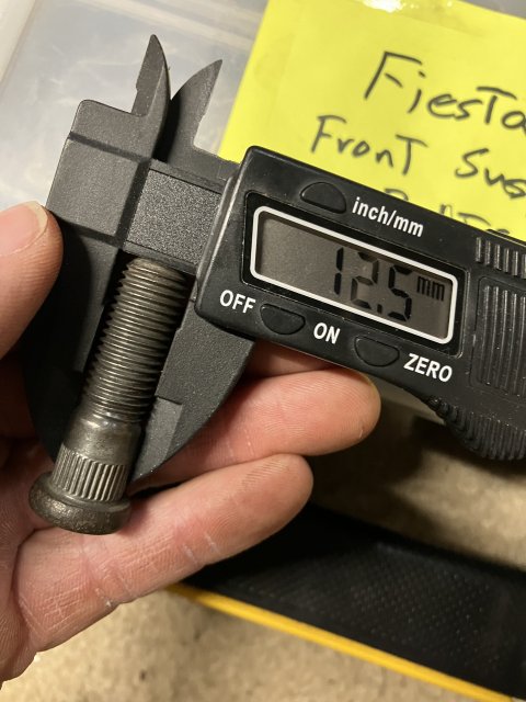

How are you measuring the wheel stud? I am getting 12.5mm diameter shank. North American Fiesta May be different. But, must agree that longer cannot be a bad thing.
