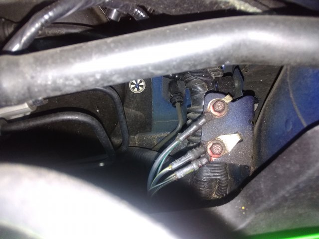

It's easier to remove the Battery to get access to the ground connections. It's not a bad idea to be prepared to give the battery terminals a good cleaning and condition inspection as well.
The original 500cca battery is being worked to it's limit from the minute it's dropped into the tray. IMG_20200901_075429.jpg
The original 500cca battery is being worked to it's limit from the minute it's dropped into the tray. View attachment 4076
Thanks for sending this. I went ahead and cleaned the two connections and also the negative cable from the battery. I made sure there's no rust or paint under. Still the same 🙁

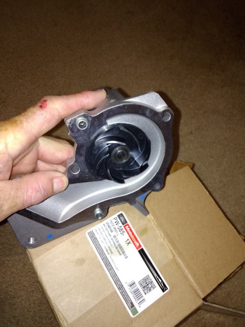

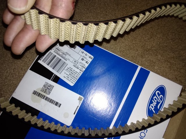

I did the timing belt, tensioner and bolt and water pump on my blue 2011 last fall.
I should have taken a few pics of the original belt condition. I have a pic of a new Ford timing belt for a Fiesta. As well as the water pump. The pump fails much more often than the timing belt. The O.E. timing belt is very robustly designed. It has a high density plastic material impregnated into the cog face. This material has to be gone through before the cog material can be chewed up. IMG_20200903_065038.jpg
The water pump does have a plastic impeller, but it is also quite beefy. The seal and bearing are the weak point of this piece.

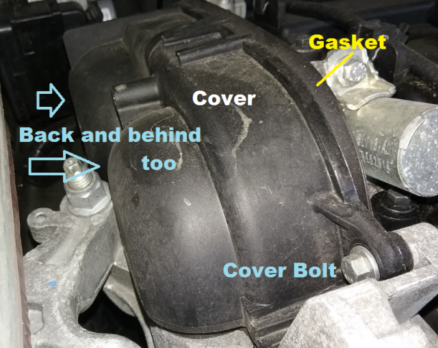

The Water Pump is behind that Timing Belt pulley cover, but it's shaft protrudes out to a pulley and is driven by that serpentine belt.
Without having to tear down the entire side of an engine to inspect, you might have some luck in removing the cover plate on the side of the motor where the pulleys are - there's a case cover to inspect the belts and also see the timing marks and for it's alignment.
The plastic cover uses a gasket and has several places to unbolt the cover from the cast.
