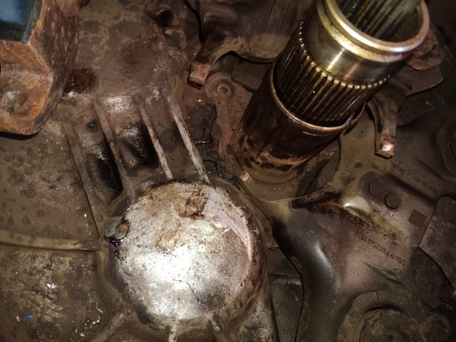

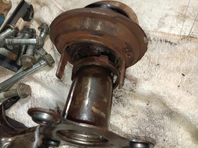

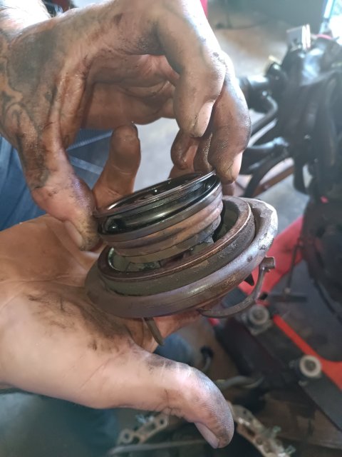

The photos show the damaged bearing, and what it looked like when I got the clutch out. The sleeve was split but I did not get a photo of it. I welded it so it would work then thought that wasn't a good idea, bought a new one.
My biggest concern is the counter? that is mounted on either side of the shifting forks. Everything Ive read, and watched mention there should be 4 number on the counters that match 4 number on the shifting forks. If you an see it, there is not matching numbers, and the counters are quadruplets, all the same number.

It may be easier to just get another transmission and install it - you got this far - the amount of damage from rust and seal issues are two-fold - this may be a loss. Most of what I see is water damage - on one of the actuators is a spade-like tab that pushes and pulls the actuator into a position to either rock back n forth or up n down - as you can see by the shiny metal left behind from their work in making the gearbox even shift into the next gear. The concern comes from the actuator when you took the photo while it was still in the transmission - the rust is what got my concern.
The number issue - once installed you're committed - so the issue is more of the size. These "numbers" are a game of wits and age. The problem comes when Ford decided to close down the line - they Amortized the parts, even down to the Actuators to use up stocks piled in various warehouses throughout the world - so they generated a "Hodge-podge" of assemblies that use parts from various sources that migrated as the years of production ran their course. The "connector memory" comments I made in previous posts is akin to what I'm getting at here...
The numbers are a lot and date so them being all the same usually indicates the same configuration and dynamics (meaning throw, turn rate - gear size and mesh equivalents e&c). IT means nothing if you don't know the sourcing of the parts - just final assembly is this result; like a serial number - but the caution comes from the regions of the world that may have closed down and finished off only to have other regions take up the dies and stamping to continue until final closure of the line
Why am I saying this might be a loss, is due to the spindle on these gears - if the throw depth and the gear used to push and pull were not compromised upon inspection, I'd say go ahead and install the new ones. But the SHAFTS they use on the transmission itself are pretty beat up from the rust which indicates a water-entry (or operation in a proximity to water) signals corrosion - which is why you see the seal results like you have.
IF you try to put these in, the wear on the spindles (cog valley to gear tooth - the mesh) may be too great of a clearance so it would generate error-codes that won't go away no matter what effort you tried - best to hold onto those actuators and or return them and just get a rebuilt transmission - and keep this one for further inspection and learning tool - and use a lot of rags and napkins to keep the fluids and mess contained to the assembly.

Thanks for clarifying this - it's just sad to see that how the seals and what you held in your hand for the photo was. To me this is "age related" wear - don't know how many miles were on the Odometer when you got this. But it shows the typical "beat-up" pitting wear found on parts that although part of the assembly - were not load bearing but part of the assembly that does. Although not required to have a finish on it - wonder if the darkening (since I don't have the part in front of me) areas are "etching" left from the metal present in the medial that can produce a "vaporous dust" - reacted to the base metal changing or etching the finish. There appears to be some heating or blistering of one of the outer seals - like a bubbling effect - like heat got to it.
