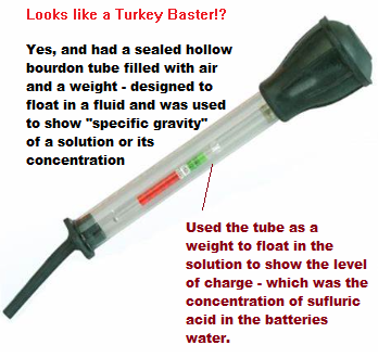

But your Dad, may have used this device
A Hygrometer, in some form to check his car battery.
  • As a sidebar:
    • These testers were (in some cases still are) popular in both battery and in Antifreeze testers.
    • Sulfuric Acid was one of the mediums Fahrenheit used to show temperature as a freezing point of a fluid into a solid - typical Battery Acid (straight form not modified) freezes at 0F - not 32F like water does - at sea - level atmospheric pressure.
    • SO2 (Sulfuric) Acid will also boil at a lower temperature than that of water 212F versus ~185F.
    • And is more sensitive to these triple points at lower atmospheric pressures (mountains and elevations) above Sea level.
