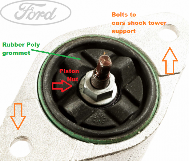

Pull back the felt in the back trunk and boot to find the shock tower upper mount...
Might want to check the bolts - it uses two on a metal cup to hold it to the car, while another nut holds the shock to the cup that bolts the shocks "piston rod" to the mount, the other two bolts then mount this assembly to the shock tower support
The reason this comes up is if the shock got damaged, the cup can crack and eventually fail - causing this rattle.
The Piston to nut also - that grommet can "push out" if the car got into some potholes and or rough road and heavily loaded. It can then rattle around and the upper rod can bang against the cars tower support.
You won't see any true effort unless you take the shock out and test it separately for looseness. For the piston itself tries to seat the whole affair when it's at rest - the noise can be from the extension hitting the cup or making the grommet rattle in the cup.
