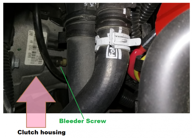

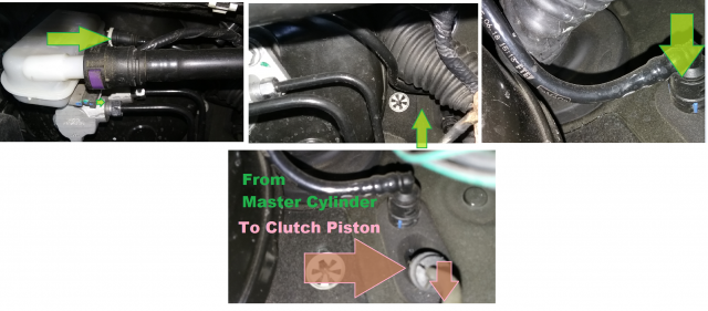

While I was trying to investigate, I took some pics of my Fiesta - SE 2018 ...engine compartment.
Found out some stuff that can make you wonder...but then maybe they can help you piece together a plan...

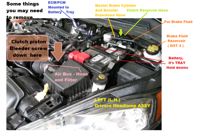

Ok, some orientation...

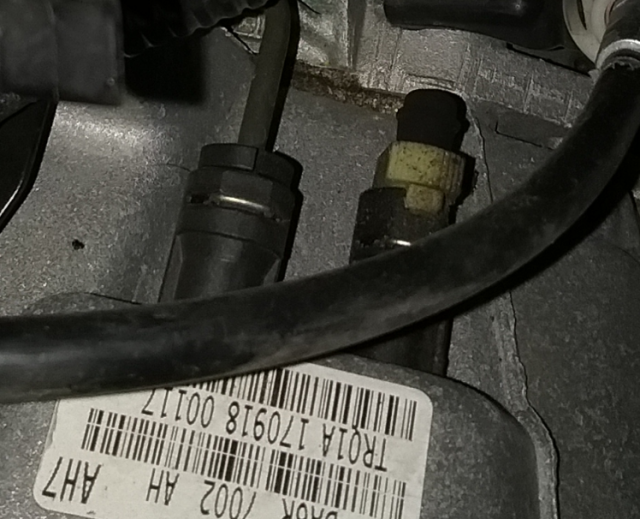

See that Clutch Piston Bleeder Screw Arrow?
Peer down there, you'll see something like this...
So you'll need to figure out what you have to take off parts and remove the battery and it's tray, push aside the ECM and remove the Air Box, it's hose - so you can have room to bleed down that clutch.

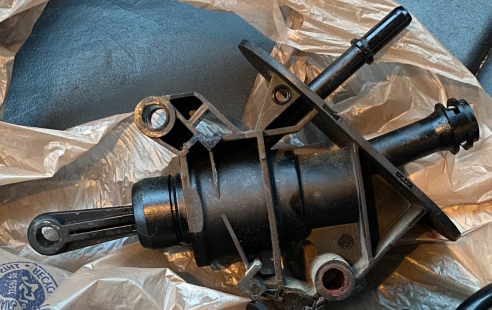

But there is a hose that offshoots from the MASTER Brake Cylinder, it's nylon and routes to the firewall...
So be ready...
So be ready...

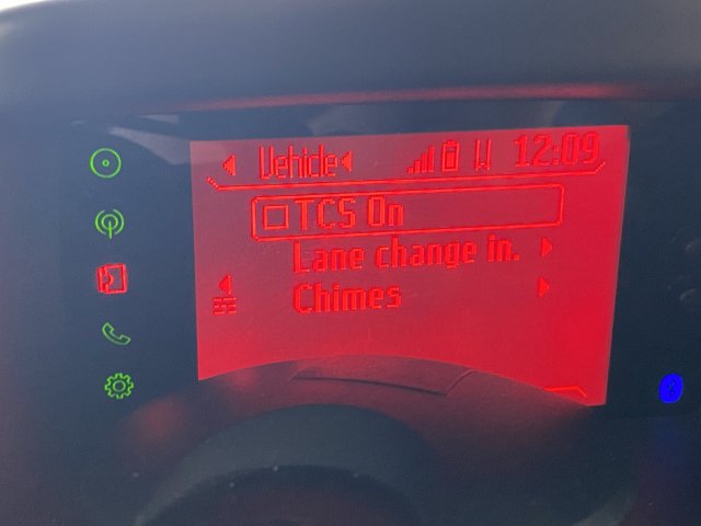

Thanks for the ideas Handy Andy!
My 2013 manual trans doesn’t have an On/Off for Traction control 😂, or it’s labeled as something else that I’ve never tried

E57F67DD-85A6-48D6-98F9-BB0030D38D0E.jpeg 👀 Okay, so maybe I do have it 😂 I’ll have to roll through my system, but pretty sure I don’t have the “Information Display” it is meaning in this book. Haha
I feel dumb 😂 TCS was On, it is now Off. We will see haha 7F8F9AF3-4A3D-4CC8-8E91-456AE143F18E.jpeg
