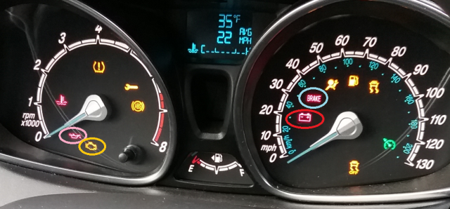

Your Dashboard "pods" display - DASHBOARD...Indication Lights - Instrument Cluster...
(To Help - I had my Sealt Belt on - so you do not see that light on on the Dashboard)
See the Circled ones? Those are the ones that once the SELF-TEST is completed, they DO NOT wink out...they stay on!
The other non circled ones - yours may have different symbols or not even there - it depends on the feature level of the vehicle...these will eventually wink out...
Ok, the Blue circled one is if your using a Manual or need Parking Brakes - BRAKE light is if you use the E-Brake...
  • - but at least 3 of those lights stay on,
  • OIL PRESSURE
  • CHECK ENGINE
  • and BATTERY (Electrical Alternator Charging system)
  • BRAKE is if you have The Parking Brake engaged, or you may have the reason for the chimes if this light is on when you DON'T have the Parking Brake Engaged. Check your Handle on the Parking Brake - make sure it's all the way down to the console holster.
The above are the ones that REQUIRE the engine to be running for the status of them to change and go off.

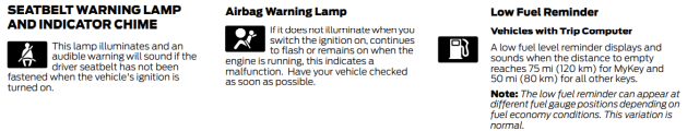

The Seatbelt reminder - check the PASSENGER seat if you have your purse, heavy object or a 2-Liter of Diet Soda on that seat - there's enough weight to make the occupied sensor go off and you hear chimes...one particular pattern...
Same goes for SRS - if you are driving - this may chine in a different pattern of chimes - annoying as heck but it happens - have the system checked...
The Low fuel light, will have a particular chime to sound - but also remember that to reset this - your need to FILL UP THE TANK past 3/4's full to reset and clear this annoying alert.
  • If you have MY KEY enabled - a specific key can be programmed to display Information and Chimes if some conditions is/are, not - met.

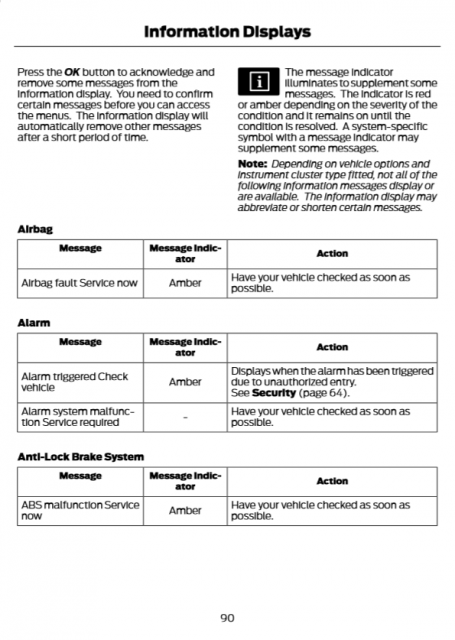

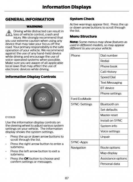

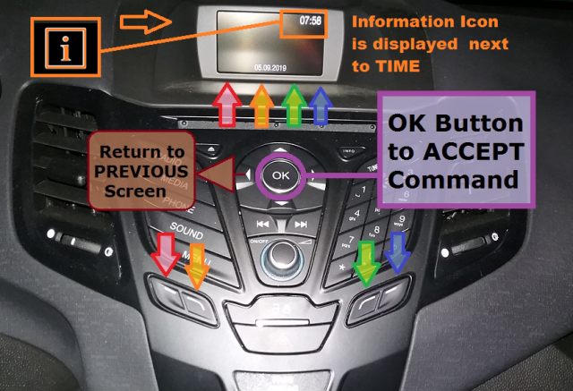

Then look at your console - and also look and get familiar with the "OK" home cursor keyboard - press up or down - Why? Look for a little
INFORMATION ALERT
Symbol in your Main Console Display
Located in upper Right Corner.
Your Console may differ - but will have "OK" button....
Find your Manual - you may have some other more immediate information to look for up to and including Seat Belt and or Engine Malfunctions you may have to scroll past the immediate information to get to.
...start on Page 87...
