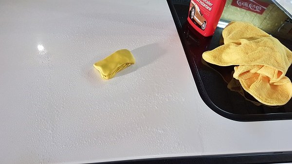

Clay will remove hardened tree sap, road grime, rail dust (small embedded metals from brake dust) and insect remnants.

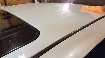

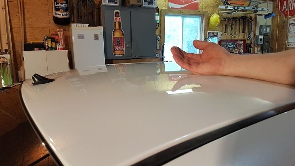

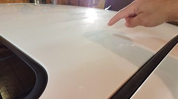

Once clay has been completed, the paint should be soft & smooth. Running your forearm across the surface will reveal how nice and clean that canvas is...
If you can still feel a rough surface or friction this is a sign you may have considerable oxidization on the paint. This commonly requires compound or polishing the surface. Clay can only remove so much, if compound is required, that will need to be addressed to ensure the wax can adhere properly. (Paint correction thread to come eventually)

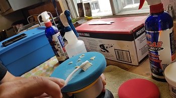

The first step to DA polishing success is to ensure you mark the backing plate. This gives a means by which the rotational speed of the pad can be monitored...remember from Detailing 101 thread?
DA backing plates and pads are fitted with Hook & Loop. Apply your pad centered on the backing plate. From this point forward always place your polisher with the pad facing up to keep from contaminating the pad. Start with priming your pad with product. I usually begin with a small mist of water from a spray bottle just to dampen the pad. Then apply product and work it into the pad.

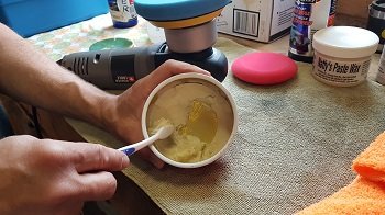

Once you have sufficiently primed the pad, choose your location to start application. With the polisher off begin by "kissing" the paint across the area you are working. Dab the pad on the panel to leave prints of product to collect as you work the area. This will ensure you dont have more product where you started compared to where you finish this round.

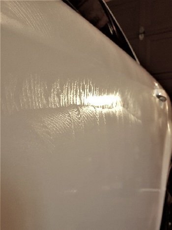

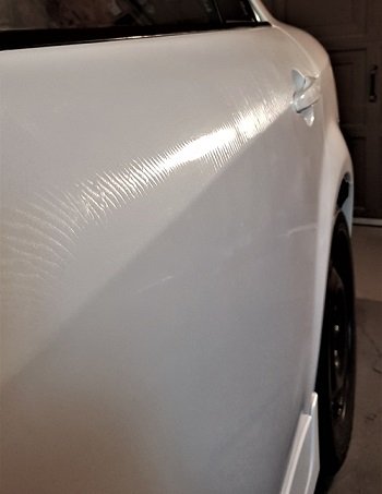

1. Keep the pad level with the surface at all times. If the body contour changes, so does your pad maintaining flat contact always.
2. Only apply enough pressure to slightly indent the backing of the pad.
3. Maintain a slow rotation of the pad approximately 1/sec. Adjust polisher speed to dial in rotation.
4. Work in a North/South pattern then switch to an East/West pattern. Always overlap your last pass by 50%.
Once you have applied, you should have a nice pattern of close rotational marks even spaced like bones in a fish.
