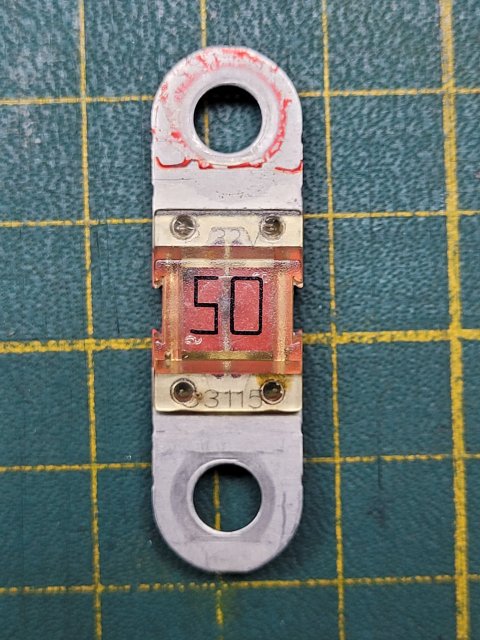

Update: I guess I don't understand how these forums work because there was no response. Just in case it helps someone else, my wife discovered that it was the 50A High-Current/AMG/Midi fuse at the front of the battery box. I tested it and found there was 12.5V on the + side of the fuse and less than 2V on the other side. When I removed it, some of the solder(?) was rattling around inside the fuse. I replaced it and have not had a problem since.
