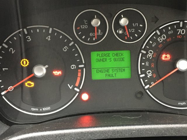

ford fiesta 1.4 zetec petrol . Car had drove no issues . Parked up for two weeks, went to start it and wouldn’t start. Engine not turning over all usual lights on plus engine warning light. Display said . High temperature warning engine fault.

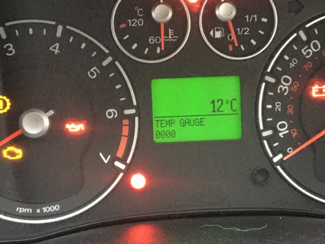

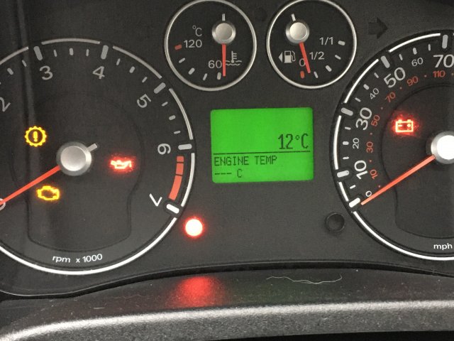

That’s a pic of the dash display

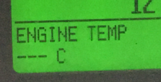

Thanks for using that Test Mode - it certainly shows that the engine temp sensor has either failed or the connector is not seating well enough into it.
Place a tester - set it to 20K (or 10K setting) and see if an ohmic reading shows up - check it to the case (threaded portion of the body - if it uses the style) make sure it is not shorting out.
IT also may be a diode (PTC) - so it might need to set the DVM to Diode Check and see if the diode is open or shorted - for you should have a reading of something only one way - if none or shows a dead short either way - well, you have an answer.
