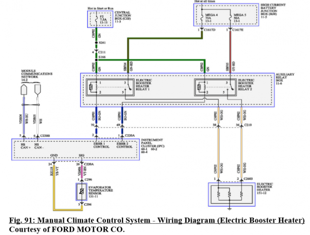

There may also be a "Auxullary heater" that equipped in some models - you'll have to "run your VIN" to see if the option is installed on your Fiesta - if it is, that may be what this problem is.
There are fuses in the passenger (side) behind the Glove Box - this may be where the Auxilary heater fuse also resides - so you may need to check to make sure your AC system works but you may have to verify the Auxilary heater is not countermanding your AC unit - might have to locate that fuse and pull it to verify if AC works, then the controller for that AC system, is bad.

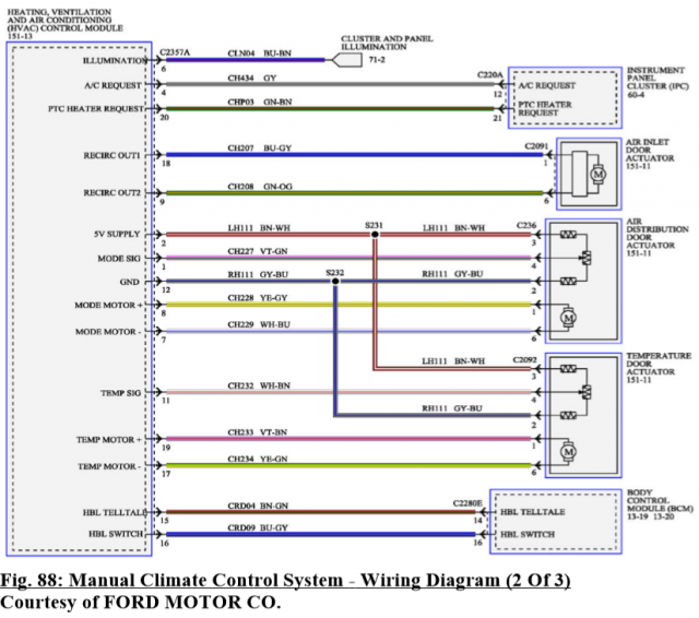

To help identify some of those "motors" heres a graphic showing COLOR CODE of the wires to these actuators.
You may be able to locate the correct one by identifying the wire color code at the connector to it.
Here's another graphic, showing the auxiliary heater wiring color code and the relay for it is in - behind the Glove box.
Once you can find and identify the correct motor - if the actuator is bad, it won't move, but if it's simply ajar - the pin from the pivot on the output shaft - is not matching the "tab" the door is attached to, just unscrew the motor pull it out - start the car and move the heater controls to see if the motor is jammed or working - then once verified, the motor output pin and the tang/tab the door works with - just need to be aligned and then the actuator is reinserted and screwed down.

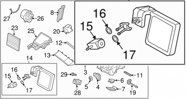

While you see these working, is the vents Air temperature changing?
Then if its not, you can have Freon Pressure Ok, and even the Compressor...
But the problem you may have is the Constriction that forces the compressed (Compressor side) of the FREON to expand in the passenger compartment. It's called the Expansion Valve.
Expansion Valve - Ford (AV1Z-19849-C)
It would contain the restrictor - for the Evaporator side (Cooling side) to work.
Part number 15​
IF the Freon doesn't expand, the FREON can't cool, just blows hot.
So if the vanes in the motors to make the air vents blow air and work their Magic are ok, the orifice that makes the Freon cool from the compressor side, is bad, dislodged or damaged.
