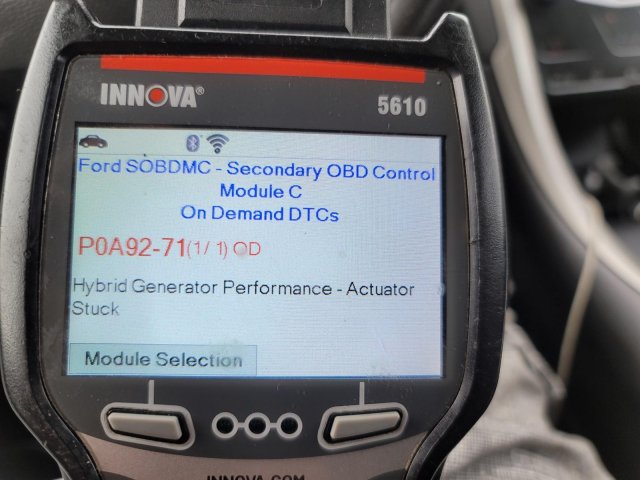

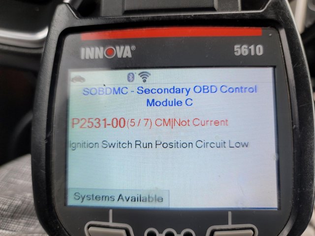

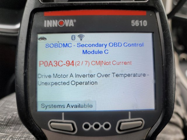

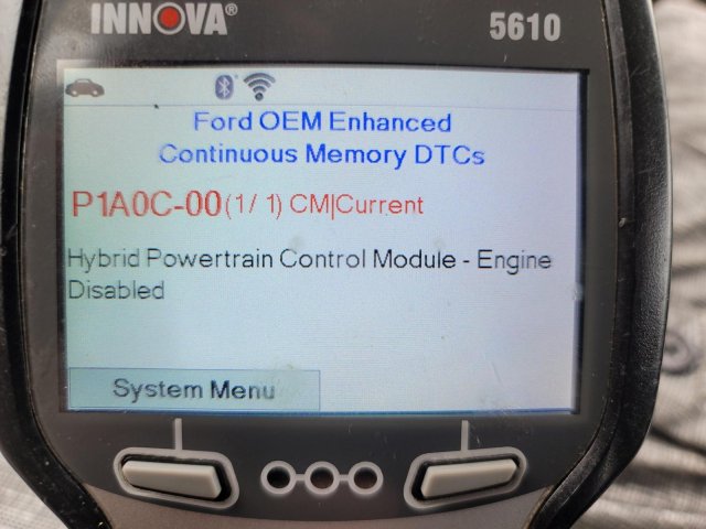

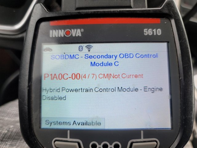

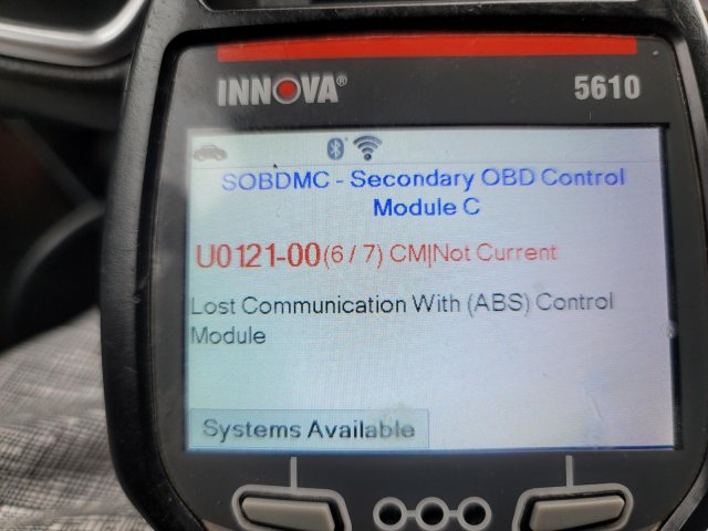

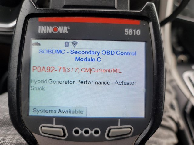

Here are the 6 codes we pulled up:
P1A0C-Hybrid Power Control Module
P0A92-71-Hybrid Generator Performance-Actuator Stuck
P0A3C-Drive Motor A Inverter Over Temperature
P2531-Ignition Switch Run Circuit Low
U0412-Invalid Data Received from Battery Energy
U0121-Lost Communication with ABS Module

The vehicle having over 200K - has any service been done to the brakes?
It may be more of a drivetrain issue - a seized bearing or failed brakes (see the ABS error?) or shorted battery in the bank of batteries that now poses more of a fire risk than anything else - caused by the system seeing a huge demand for current - cannot supply the charging demand asked on it. And the motors can't turn without power to assist the Gas-powered side of the car - let alone recharge the battery bank used to assist the electric motors for that assist.
The Batteries themselves may need to be replaced - the "inverter" on Motor A is a strong clue as to conditions with battery but to cause the drive issue - it is possible the Drive train, that may have a bearing seized on you - possibly due to overheated brakes or a failed CV axle and bearing combination the motor cannot turn against. A failed communication with the ABS system may mean a failed sensor or simply not enough power from the charging system to keep the ABS system "alive" so it powers down and sends a DTC code.
