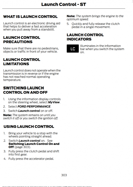

You do have a lot of features available on that trim line. So you might want to investigate the owners manual a little further - there is a section called "Launch Control" which helps the vehicle start out in 1st gear from a standstill by helping you with the RPM control while you work the clutch - it's worth a look...
Here;s that Part about Launch Control...

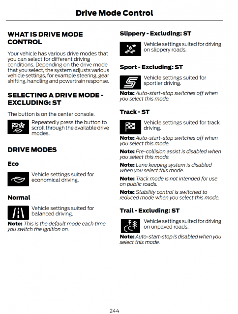

Yes. Your car, being a Mk8, has a number of drive modes to choose from. You may just need to read your owner's manual and set it how you want it.
