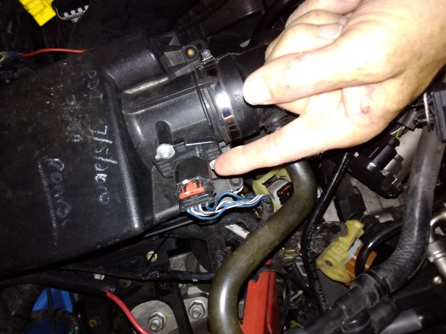

This image of the MAF harness is where I would be looking first. Broken wires, or connector not seated?

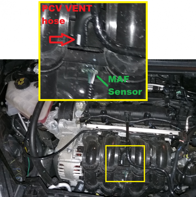

The PCV valve? Requires some disassembly - you need to at least gain access to the PCV valve. That may mean you have to remove the intake manifold to do this. In the photo, it's behind the hose.
If I knew of a simpler way I'd tell you, but taking apart the engine's intake manifold may be your only option. There is a "plate" that the PCV value seats into - this plate has a seal to keep it oil and air tight The engine gathers fresh air from the airbox off to the right in the photo and you can even see the hose routing into the top of the valve cover - that hose - you can pull off and cover the valve cover side of it with your finger - carefully - usual disclaimers HOT engine parts and moving equipment - and see if a vacuum can be formed by plugging the hole with your finger while the engine idles. The longer it takes to form a vacuum, may indicate leaks or the PCV valve assembly is not airtight. IF you see oil where the hose routes to the side of the engine - this usually means the hose or the plate seal has failed and needs service.
The PCV valve may need replacing - it's not impossible but if someone knows an easier way to fish it out of the intake manifold without having to tear apart the motor to do it - I'm all for it and would like them to post the procedure here to help the rest of us.

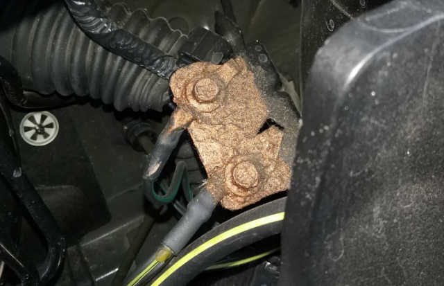

You have to gain access to the Positive cable connections...so you can inspect and
clean out any corrosion or fix loose cables.
Positive post terminals and
Battery returns too - Behind the battery on the engine firewall.​
TCM? That more than likely is a Battery power or ground cable issue back at the battery - the red cover for the Positive post has a series of bolt on fuse links and connectors - so if these are getting too badly corroded - they can make intermittent connections - so try to pry off that red cover and see if the wires are properly seated and the bolts are tight and not corroded.
