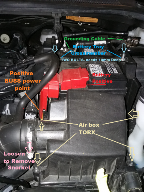

Begin to take / Remove - the Battery Tray, It's cables, wire ground and even the PCM - using
10mm Socket - Ground Cable, Battery Cable main post, Battery cross bar holder (Deep socket works best)...
12mm Socket/Wrench for main LUG to Positive Battery post - that "RED" buss terminal...
8mm and 7mm as needed for PCM to loosen and swing it away...
Long 6" or 8" or 12" extension to fit your socket set you're using...
TORX 27 External "star" tool to remove the Drivers side Headlamp...
TORX "Star" set to help remove Airbox top even it's main assembly as needed to obtain clearance...
Phillips #2 to help with removing Fasteners that are not using TORX heads
Long reach thin blade Standard Screwdriver - to pry off trim and holders to obtain access to BUSS wiring

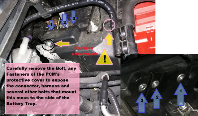

PCM - Removal (CAREFULLY HERE...)
The biggest of the job, is to get the Battery and it's tray outta' there so you can get at, and get room for, the work and cleaning that may need to be done. Rusted bolts are no fun, but the sooner this job is completed and put back together, your efforts in costs of doing this job will be rewarded by not just the satisfaction of doing this yourself, but learning how this is all put together on top of the less problems you'll encounter with this electrical scenario later - you won't be bothered by or be sorry for, the work you did to protect your investment here...

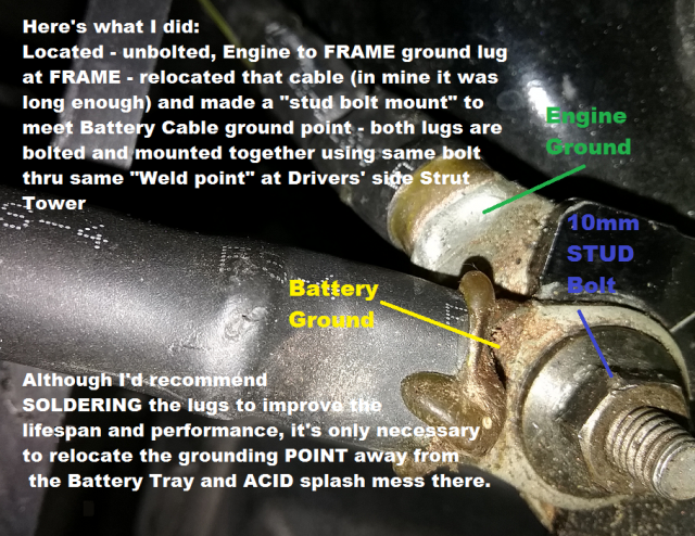

The Main "battery ground Lug" to the engine was, (on-mine) - located under the battery tray between Main Block and Transaxle...
It's "lug" (Battery) to Frame - located UNDER battery Tray, on Engines Compartments (to the Inside on Frame) Frame by Tranaxle Motor Mount under Tray.
Want some relief? Relocate that "frame" to Battery ground point.
One thing I do recommend - REMOVE THE DRIVERS SIDE HEADLIGHT - unclip it's harness, undo those 2 - #27 TORX bolts, and 1 Philips head plastic screw holder from the front cowl and grasp the headlamp and cradle it, then; in a lifting-up motion yank it up firmly but lift it carefully out - set it aside on some cloth to protect the lens and case - and so you can see more and have the room needed to do your cleanup.
Locate your Other Lug Battery Ground terminal at the Drivers Strut tower, (OEM) it too can become your "ground point" - BOTH Cables can be BOLTED together here at the STUD bolt where the Towers' Frame "tang?" can be SANDWICHED between both lugs with a bolt thru to hold and pass current thru both terminals and main vehicle Frame.
It's now protected from the leaking Acid that can occur when the battery "Boils" on hot days - or you wind up with leaks because it's tilted from you're forced to stop at weird parking angles or intersections - even traffic jams. These moments are rare but where leakage from the battery vents can collect and drip down onto the frame and cross member and your wiring harness and their ground points. The Ground cable can be rerouted to a new location where the Battery Cable Ground and the Engine to Frame ground can share the same "WELD-BUSS" point. This is at that Strut tower ABOVE all that mess.
I only had to undo the main Frame lug side, it uses a simple bolt threaded thru to a WELDED nut, it's nut on the inside of the frame and spot welds, so you already know you're borrowing time - so the sooner this rewire is done, the longer the battery, connections and your vehicle - will last. There is a side benefit to this effort as well, your wire runs and voltage drops are minimal when you connect all your grounds to one tie off. Simplifies the inspection and reduces the maintenance effort required to keep things clean.

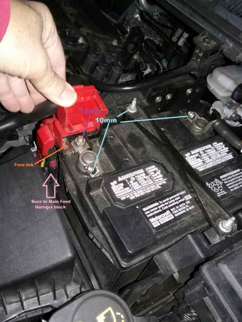

The Battery work you'll need to gain access to is located under the Battery and behind the Airbox.
Your main problem? May be at that BUSS point off the Positive Battery Cable side.
That section uses simple Lug to Spade tangs to hold their position.
There is very little to protect them from the elements so they may be corroded and causing your intermittent problem.
See that Red terminal block? It uses two bolts - one for the Battery post, the other is a steel chrome plated "feeder" system that - after going thru the Fusible link - breaks out into a BUSS system of contacts using Bolts to hold lugs and or spaded terminals.
When you undo the 12mm nut, the Buss and the Battery terminal separate into two pieces, one for the Battery post, the other is to those various wires that; for two of them; one is for your Starter and the other is from your Alternator.
There are other less hefty terminals off of this BUSS that are branches to provide power for various systems - like; Engine compartment Fuse Block, Passenger Compartment Fuse Block and other systems bolted to the vehicle in one place or another.
When you lose good connection or have corrosion at these connections - their lifetime to support the current draw and provide the least level of voltage drop - becomes limited - shorter. Terminals use metals - that are conductive when they are refined, but when they are in their reduced state of ore, are more like insulators - don't conduct power as efficiently as when they are refined.
