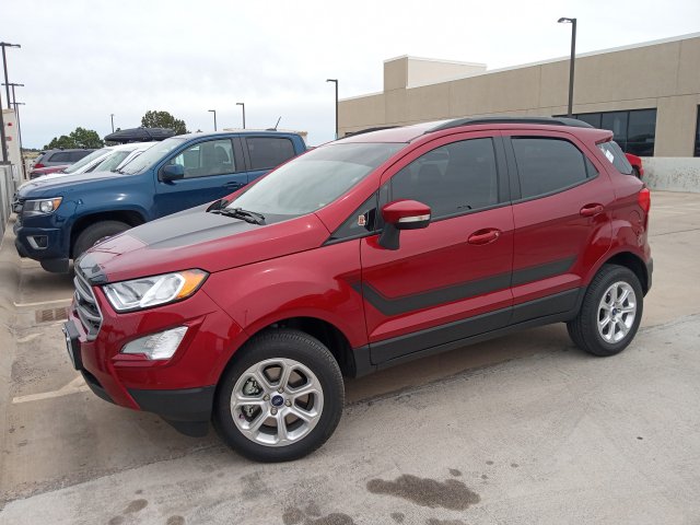

Stock EcoSport Wheel Information:
17"
16"
Size: 17x7" - 47.5mm
Weight: 22.5 lbs
EcoSport Hub Centric Ring:
63.4mm Hub Centric Diameter
Standard Fiesta Wheel Offset:
15" - 42-45mm
16" - 42-45mm
17" - 42-45mm
17x7" - 47.5mm (Included)
18" - 42-45mm
Depending on the wheel, you can go with an offset from 35mm to 47mm. The OEM EcoSport wheel weight is 22.5 pounds.
