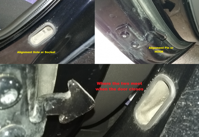

IT may be a simple "strike plate" to door latch adjustment.
OR a Pin to Index hole alignment keeping the door from closing all the way.
Look at your rear doors - you see these forks and holes...
