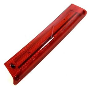

The bulb chart says LED. It doesn't have a replacement bulb number.
It is serviced as an assembly because the diodes are hardwired onto the board.
The LED lights are one-piece units - with a Squirt-Squirt hole outside for the Rear wiper washer unit.
No incandescent bulbs are used in them, these are Solid State LED (Light Emitting Diodes).- integrated since the 2012 Fiesta I know of.
So when you take them off, there is a small hose, (Windshield washer) the wiring connector and the spoiler rain shroud - all removed as one assembly to gain access to the Center LED unit. You have to remove the shroud for ease of access to the LED light and obtain clearance to remove it (pulls out from rear of the panel - which is towards the front of the vehicles which has special "press fit" trim attachments to hold the shroud in place. There are several places you have to remove torx-type (T20? I think)

But either way, the unit is still a one piece LED strip.
Part number...
8A6Z-13A613-S
Center High Mount Stop Lamp

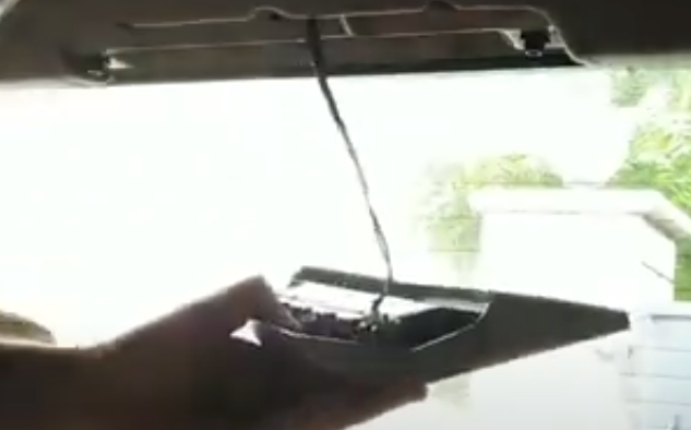

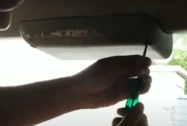

If you have a upper cubby console that houses the Lamp.
Tiny little two wire
Pinch tab to release
