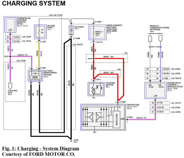

  • In the above schematic, the Alternator produces power thru the Regulator that is built into it.
  • But...to "boost" power output - the PCM, BCM, ABS and EPAS also have a "Direct line" to the power "company" the Alternator.
  • The Violet wire - changes the Regulators workload from "Standard" to higher current - which also is monitored by the PCM, and the on-board Regulator itself at the Alternator - so it does not place wide swings of voltage onto the output terminals that the electrical system could get damaged by - hence the "Monitoring" part.
  • The PCM can see the swaying current load and adjust the Regulation by a method of override that lessens or increases the LIN sense output to the regulator and help control load and sense battery condition.
  • This system relies on GOOD CONNECTIONS to all systems and points involved to be able to even sense changes and provide performance for the long period of time until the battery or any portion of the electrical system, fails - impacts the entire system if you have any resistive element (Poor contact) in the wire connections - the systems will not work as they once did - if these connection points are neglected.

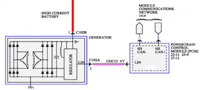

To bridge the above to a more in-depth look at how the Alternator can now work in a system that makes it a programmable support device integrated into a Network
See the Violet color wire labeled LIN? That is the Local Interconnect Network - a simple 1-wire (poised ground reference to body frame which limits data transfer rates but this also is a simple system) communication system, and uses a basic protocol. IT works similar to a CAN-bus system but designed to be more simple and easier to interface to devices without extra programming support used by CAN-based systems.
The Alternator is a perfect candidate for such a system - along with ABS, EPAS and even SRS - all can use this type of system to be taught or asked - summoned about their heath and or error conditions that would otherwise tie up CAN systems with needless redundant calling messages when something needs attention but is not part of a needed report or demand from a system - a type of readiness can be expressed thru a low-speed communication network that keeps the main system free of traffic and "state and condition readiness" collisions of packets that can hold up processing as the CAN system tries to clear them.
The system is quite versatile and can handle 15 nodes with one Master as a means to talk to and listen for traffic from the sub-system nodes.
A good example is the Alternator - the LIN system can be passed along on a DC wire - as long at the DC level is not at or near 12V (per this example) so "Data pulsing" can ring thru the line. This means the ABS system can be called upon and or the SRS system can call upon the Alternator due to it's wheel speed system is detecting issues with one or several wheels turning at different rates - so this may mean the system is encountering an ICY or poor traction condition and needs more power to provide ABS and EPAS the capacity to control steering and braking with SRS holding seat-belts tight to keep the occupants in their seats.
A secondary effect to this is the main Battery charge condition and system health can be profiled in a timed sample - over a given number of samples - the battery and it's charge condition can be then compared, even tested - and any unmitigated spike or fail, the system can log this as a type of en event and provide diagnostics to be reviewed later.
How the "errors" can be processed is by using a device to bridge the data from this lower sub-system onto another - like CAN-Bus - the PCM can provide the means - by storing the data and reporting it as DTC so it can be retrieved later.
Did you catch that?
As long as Data can be detected from the line, the system can send data slowly thru a DC power line and get processed - so this single wire system has the ability to not only power a device, but commands can be sent to it and responses can be retrieved.
So to use the word "Power" in the context is this:
The Alternator - using it's built in output terminal can be monitored by a sub-system in the PCM, with DC voltage used as a means to sense and report a charging condition - the PCM can vary that DC power to alter the charging rate and overall supply voltage - while sending data to the Alternator to process immediate needs of current and or regulation of voltage.
