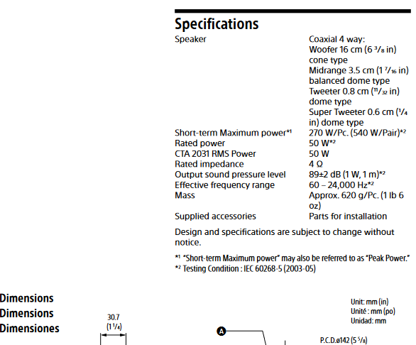

I'd guess that the speakers don't match the unit. See what ohms, watts, etc., it's supposed to run with.
Here are the specs for the speaker and the head unit, respectively. Looking it up, the stock speakers are 25W, 4Ohm. The stock tweeters (which I still have) I can't find any info about in regards to their draw. I think the head unit and speakers are compatible? But I have a hard time comparing the data between these two.

Then that means the spyder cage you put them in is in dire need of a reboot.
More than likely it is the looseness of the speaker and the cone "throw" (the length or distance it moves in its cage) striking or moving against the front grille - can't move enough air so instead of it being stationary and moving air around it - it moves and rattles instead.
Just some clearance fixing, and you should be ok.
