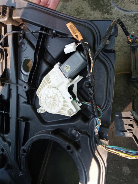

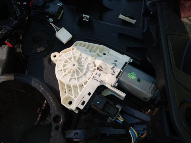

Being an international car, some drive motors are of German origin and some are U.S. built. That most likely varies dependant on where a Fiesta is assembled. All the parts in these images are from Cautitlan built Fiesta. 20210605_194024.jpg 20210605_194015.jpg
