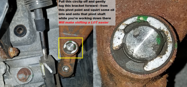

The problem it sounds like you have a stuck bushing - for the 2nd Gear ad Reverse Gear are "extreme ends" and might be binding due to a pivot point on one of the Gimbals is corroding and rusted making it stiff.
You'll have to remove the cover to the shifter so you can get at the circlip and put some oil on the posts the shifter rocks back and forth on - (see the rust on that piece? that clip is where it holds onto the post) this may help ease that shifter binding you're encountering.
