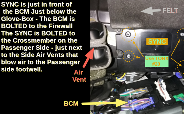

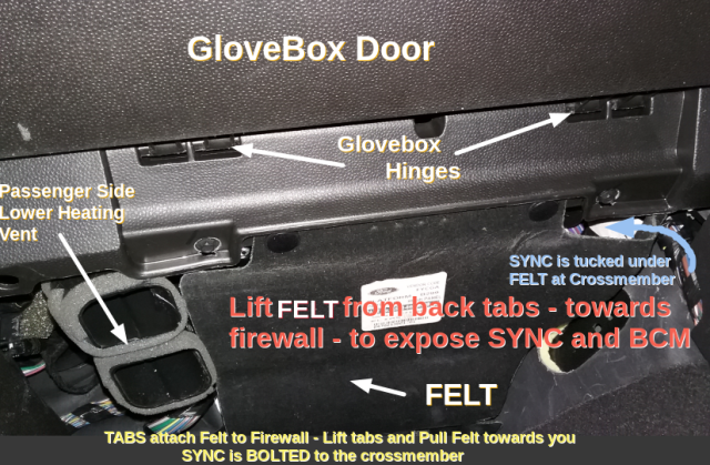

SYNC - if you have SYNC version 1 - is under the Glove Box, BELOW it - find the felt under the glovebox, pry it down - you'll see this...
Then when you lifted off the FELT from Firewall and can pull it back towards you... look upwards UNDERNEATH the Glovebox where the Passenger side-crossmember is at - below the Fuseblock - It may help to remove the Glovebox; Pry towards you at the Hinges to help with this...
Peel the Felt back to show or see this...
If you don't see this, then you have a Fiesta that has a different version of SYNC that is part of the main console display and looks like a 10" tablet(?) - if so then that tablet is your SYNC unit - else the Module under Glovebox does the work for the Display - but the Display console has all the B-Tooth stuff and communications.
