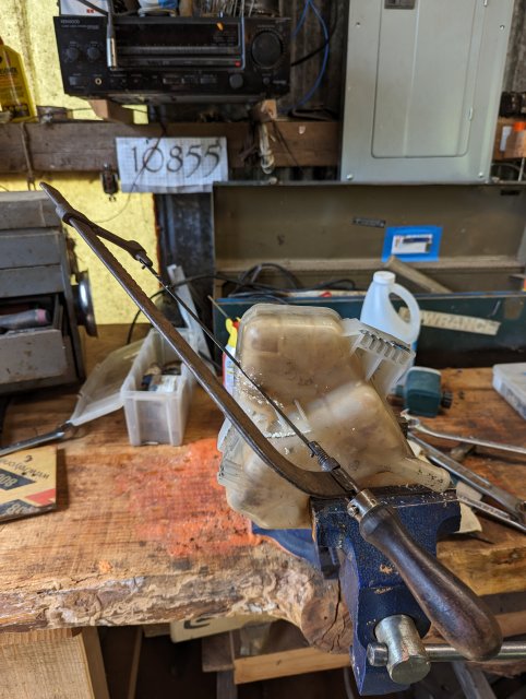

It took me a long time to find out that the expansion tank was bad. And to actually see the place where it was bad. I had to take a saw and cut a triangle out of the side of the tank. When the tank gets over pressurized for any reason, the blow-by goes out a secret passage to the bottom of the expansion tank - out a little tiny mouth that is underneath the 21 PSI radiator cap. After the fluid leaves the expansion tank it falls onto what I'm going to go ahead and call the frame and rolls towards the back of the car and you never see it. And if you see a puddle on the street you assume it's from the air conditioning cuz that's where it lands. But mostly it doesn't land because there isn't that much of it. It's a tiny bit over a large number of cycles.

I had to take a close-up photograph of the hidden leak on the inside outside of the tank. As a whole, the plastic is still intact, but there are hundreds of little fractures. See the photographs.

Original poster here. The place that I found the cracks in the expansion tank, which I called the "inside outside", can only be seen if you cut the side of the tank out as I show in the photographs above. The place the tank was actually leaking is above the general high tank level. This means that when it does leak there, it mostly leaks vapor only, and no actual liquid. The actual vapor that leaks through the spot in the photograph goes directly into what can only be called the overflow tube. This overflow tube is where the little Port under the pressure cap is designed to vent to. It is a safety issue to have it go out the bottom and not into someone's face. So that part of the design is solid. It was probably the manufacturer of the dual pressure tank wall at this overflow tube that has been the Nemesis of this engine.
In particular, when the engine is shut off. There is no additional cooling going through the radiator. This is likely when the pressure is highest - as the engine cools down under the hot hood. I look under the hood after I drive once in awhile, probably not as often as I should, but I could actually look under the hood occasionally after a long drive on a hot day and see the turbo return line boiling into the pressure tank. When the tank came up to full pressure. The boiling would stop. Mostly. I say mostly because that is when these micro cracks in the coolant tank were the largest and allowing the greatest volume of vapor to escape. All of this right on a knife edge of engineering. The tank could have been larger or made of metal or just made of thicker plastic and everything might have been fine.

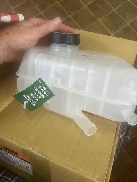

The reservoir in my 2016 ST began to slowly lose coolant over the past two weeks. I ordered a replacement when I had to give it a second topping of coolant!
The cost of the replacement part is cheap compared to the cost and inconvenience of a burst reservoir on the road. IMG_3234.jpeg
