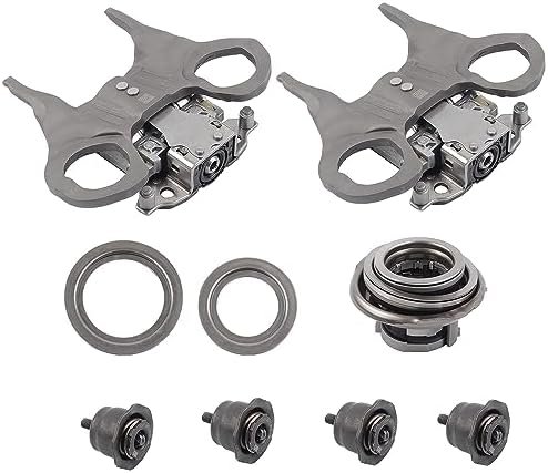

My code reader said fork a stuck engaged. So i tested fork with the spline tool and 1 sprung back but the other didnt spring back. I replaced forks with new one regardless of the issue and i didnt want to buy a clutch reset tool so i just bought a new clutch. Nothing went wrong. It went together easily. Car started right up and no noises. Now reverse is really jerky and forward is smooth.I was told i needed to reset (or relearn) whats the tool called or the model called that i can do this? I

Hi. Thanks for the response. Not the actuator (the motor) thats on the outside. Its the fork on the inside,
Also this is automatic, the dct6 transmission.
