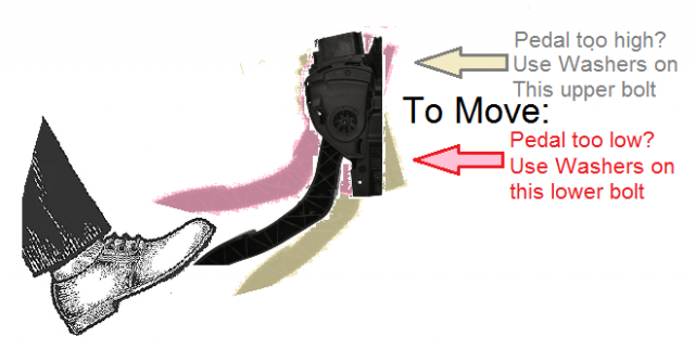

IF you just need more or less sensitivity - then perhaps a washer or two is all that is needed.
You adjust the angle the pedal rests at...by using a washer behind the throttles mount - on one of, or both of, the bolt(s) to the baseplate the pedal rests against.
This is due to the larger holes the (OEM) pedal sensor has for mounting, so it can give you some ability to tilt the pedal several degrees up - towards the foot or down back, towards the firewall or floorboard away from the foot.

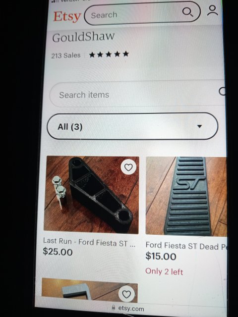

There is this one! Available from the GouldShaw store on Etsy. $25 bucks USD.
I have purchased items from all over the world.
The shipping cost won't be too outrageous. 16649271441786204802083484412057.jpg
