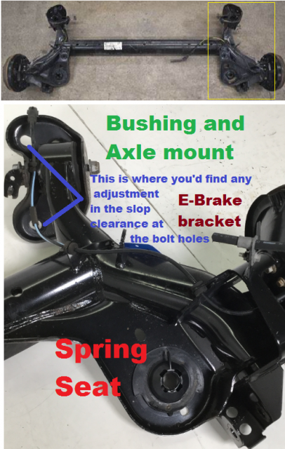

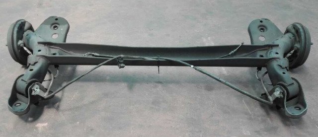

The rear Axle is shaped a lot like a Wishbone and has two pivot points on the frame,
in the axis line of the Front to Rear frame.
Two bushings, and their bolted connection point to the Frame truly - no adjustment,
- you have to rely on the SLOP of the bolt to hole bushing clearance in order to affect any effort
to change your "thrust angle"​

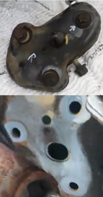

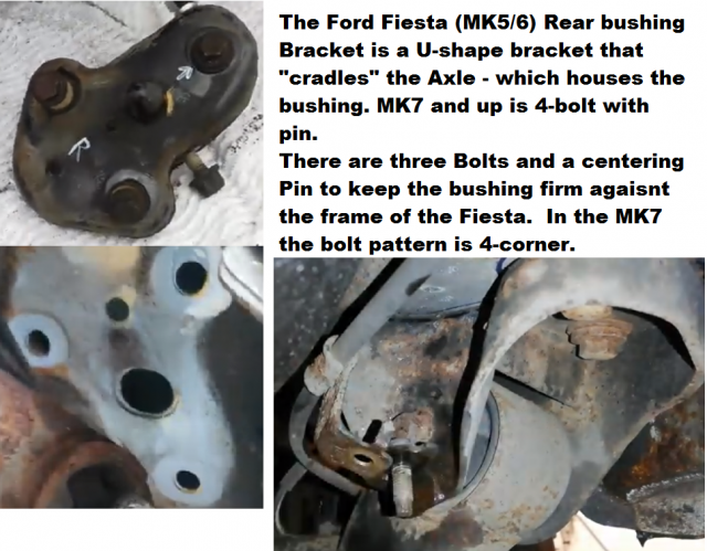

What you see from the bottom, note the rear bushing mounts are in the front of this view.
