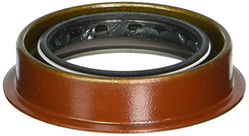

Any real auto parts store can cross reference a Motorcraft part number BRS174. This is said to fit the DPS6 transmission. 16036369_0.jpg
