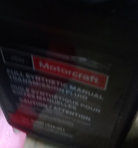

I think the Motorcraft trans fluid was around $24 a qt. Some is definitely needed if you have a drive axle seal that is leaking! The seal is not expensive, about 4 dollars.

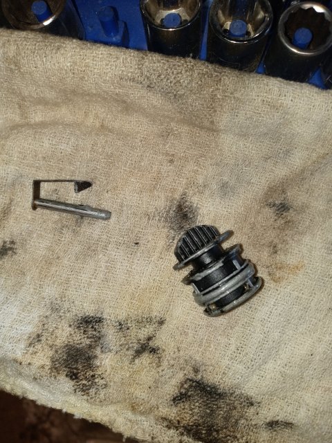

The image below is the plug and the retainer pin that goes in the side of the trans case to retain the plug. It easiest to see if you pull out the battery and the shield.

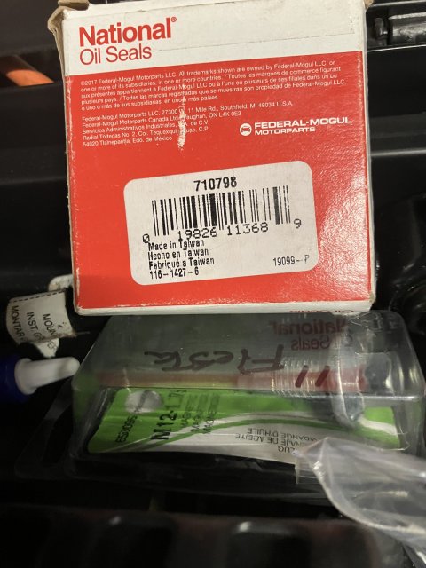

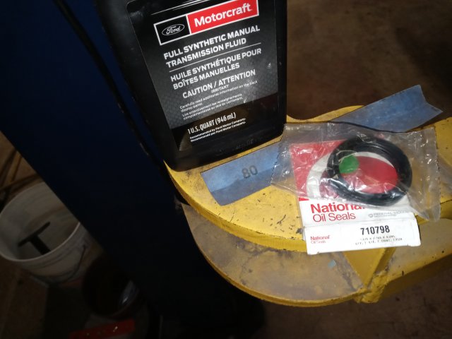

No filter or screen. I will post a couple more pictures in the morning. I had replaced the output shaft seals a little more than one month ago. But the new left side seal was also a leaker. So i am tearing back into that area again this weekend. The seals are cheap. But they are what retains the really expensive fluid in the case. Seeing even a small puddle of gear oil is the same thing as seeing money on the ground.
The image below is an output shaft seal. Costs about four bucks each. When these give up, you will be losing that synthetic gear oil. 20210131_152734.jpg
