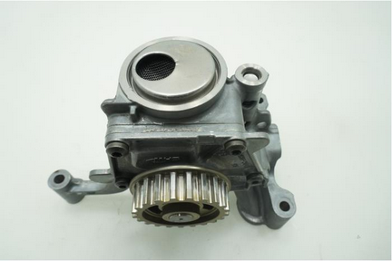

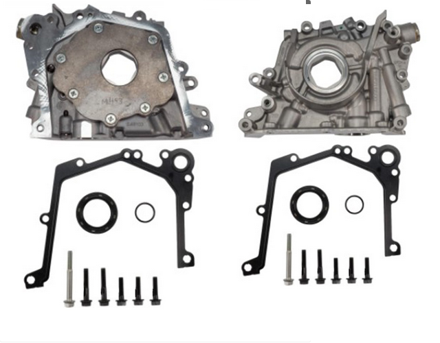

Oil pump - driven by crank gear (or lobe) for the 1.6L GDTI or TiVCT and crank driven gearing vacuums or sumps (pulls) oil out of the oil pan and then by the gearing - squeezes it into it's outlet to the oil filter
- if you have the 1.0L Turbo'd 3-cylinder - that is using what we call a wet-belt drive gear set to pump oil...the belt is driven by the crank using a tensioner assembly, that is buried, submerged into the oil

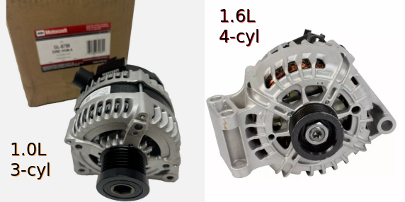

It's your serpentine belt that may need more maintenance as these systems combine their wear onto the belt for you did not mention the conditions of the Alternator or AC Compressor which are two of the major loads placed on the motor for everyday driving - and if their pulleys don't align onto the belts line of travel or don't turn freely - will destroy the serpentine belt and leave you stranded soon enough.
