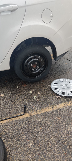

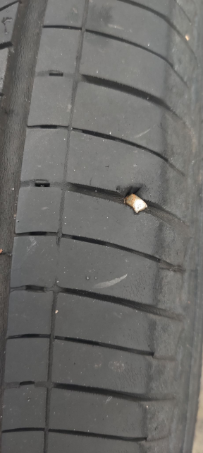

Hope your weekend goes better than mine has started off so far! Looking close at the tires, they probably needed to be replaced anyway. I assume those are the ones that came on the car originally.
I can’t see the wear bars, but yes. It’s looking like the time to get a fresh set.
