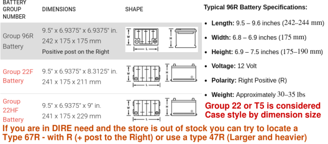

The OEM Battery is a Maintenance Free type - take that in whatever way you wish, but it's simply a Battery with plates in a Deep-Well flood design so thru it's normal life cycle, it shouldn't go dry. I said Normal - but what is normal?
,Any Battery maintained well and kept clean and topped off, DOES last longer and in this day and age, it makes more sense to keep what you have working than to take chances on ignorance and lack of car care, being your guide.

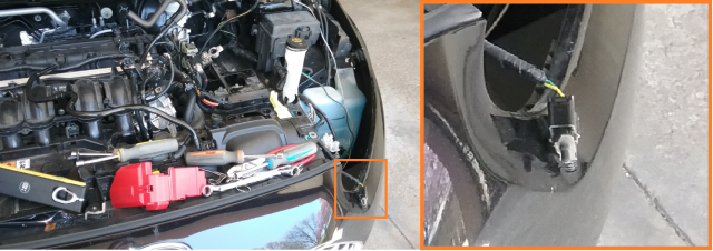

This got left dangling and made an annoying Rattle because of the original way it was mounted was
INSIDE the Grille exposed to all the salt debris and Grime so what you see above is the "wash me" moment
If you look below the probe, you'll see the two "Gator" clips - one got truncated,
Caused that when I tried to originally remove the sensor that was inside the Grille.

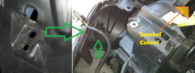

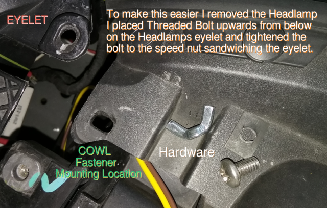

This view is the Sensor resting on the cutout of the Left front Headlamp I removed..
In this view,
The mounting location is at the Grille, you're seeing looking down inside Front Left Headlamp opening
Showing the position of where the Ambient Air temp sensor goes...
Air Box and Headlamp is removed - Snorkel Cutout to Air Box at Upper Right by Radiator shroud.
You can readily see that you can swap out the Sensor easily
just have to take parts off to get the room to obtain access to the Sensor.

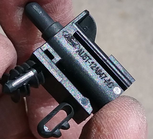

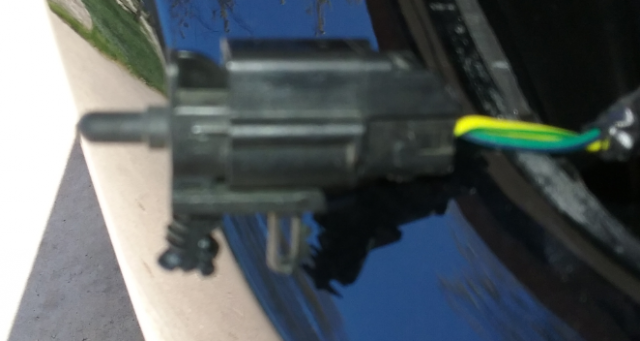

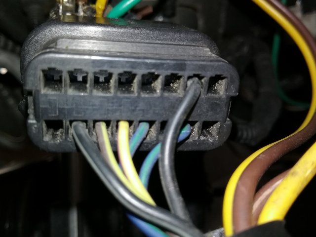

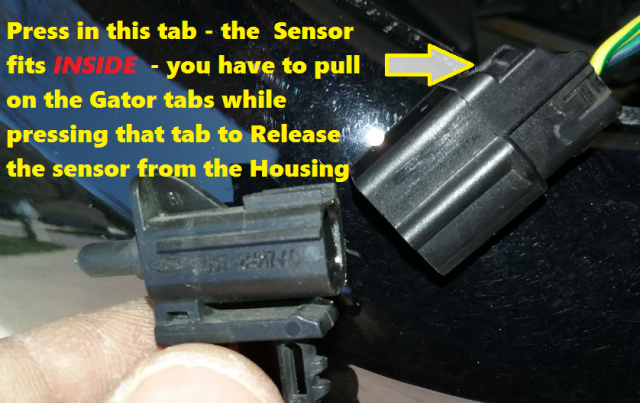

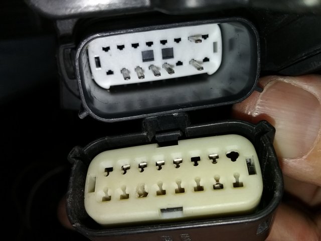

The Sensor

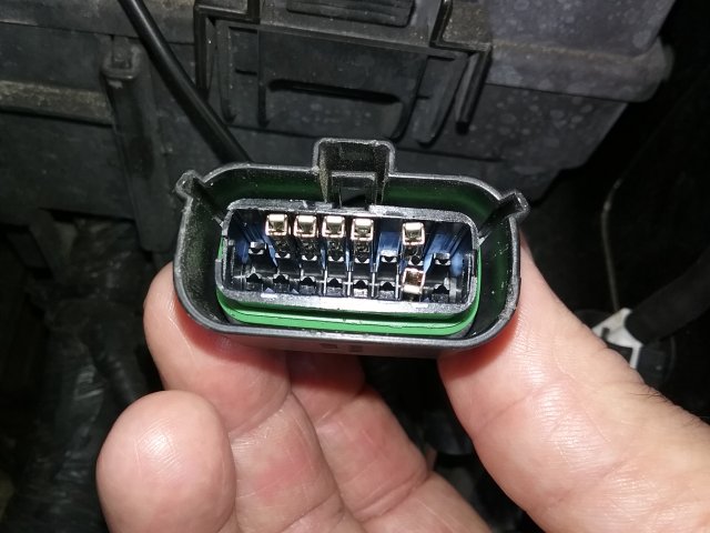

To protect the Sensor, the Electrical Connector is LARGER of the two,
You press the Tab and the Electrical Connecter as it is the outer SLEEVE that holds the sensor
pull it apart holding the Gator Tabs and TAB of the connector (don't pull the Nose - it's has the Electronics and it could get Damaged)
Those Gator tabs of the Sensor is what holds the whole mess in the Grille,
The Electrical Connector acts as a protective sleeve, the Nose sticks out into the Airstream for the temperature
The Electrical Connector holds this to the harness .
Another view to help you see the sensors simplicity and how the connector
protects the Sensor and acts as the load bearing weight to the harness
It's got a similar number per the Threads earlier postings, but this is the
NEW Part Number!

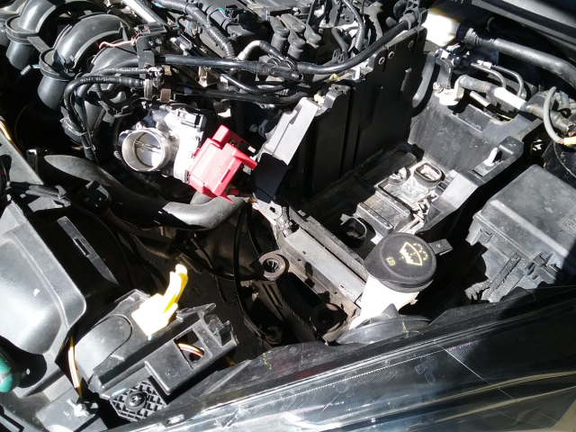

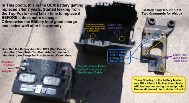

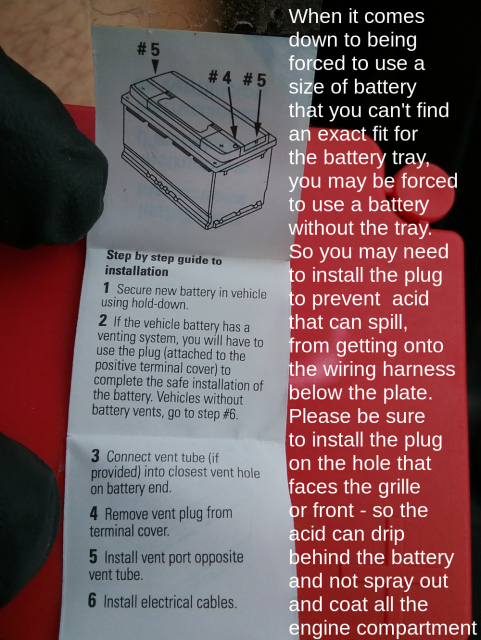

Some hints to help others with Battery and Tray issues...
Just trying to add in another "How-to's" to to help those who can...
Wear Gloves and Eye protection as much as possible.
In my Fiesta (2018 SE) OEM was a Motorcraft BXT-96R.

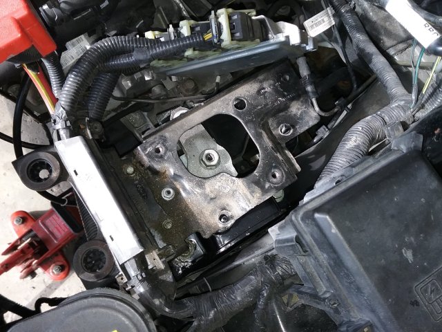

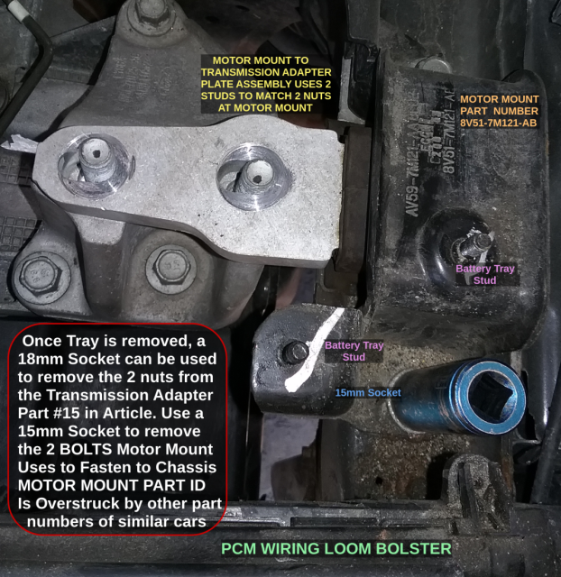

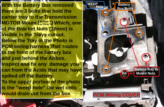

In the above mosaic - the Battery is disconnected, then the top Hold down is removed - along with it's Brace - to let you lift out the Battery - keeping it level.
When the Battery is out, Might want to make sure to clear the area around the Battery, pull off the Snorkel hose from the Air Intake to the Throttle - loosen the Hose clamp on the Throttle side using a 7MM (on OEM clamp) hex nut driver. Then (by choice) remove/loosen the top 4 - #25 Torx screws and the single side mount shock mount for the Air Box Filter base - remove the PCV Breather hose clip from the Air Box Base and gently pry away the Snorkel air diverter.

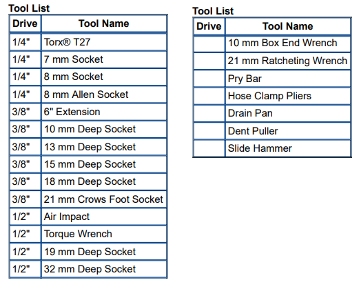

  • IF you can work carefully, you can remove the complete airbox assembly with the snorkel but remember to remove both hoses from the box, the upper vacuum purge airline and the lower PCV breather hose.
The Airbox Base can be now pulled pried up gently and removed. Uses 2 posts into rubber grommets.
You can now use a 10mm socket and 12" extension to remove the 3 bolts that hold down the tray.
Use a 8mm Socket to remove the first of 2 ECM bolts...
One the Side closest to the Front at the ECM - there is a small dimple - pry this up using a flat blade screwdriver tip to help provide the tension to release the dimple from the Tray - This will help release the ECM's cover - which then exposes the 2nd 8mm bolt - remove it to release the ECM from the Battery Tray and the Tray can now be lifted out.
Best to get it right over to a hose and rise this battery tray out well with water to remove debris and dilute-neutralize any acid residue - before it ruins you, your clothes or drips onto something in the engines bay you don't want it to.
Inspect it for cracks and stains looking for clues, showing leaking acid
  • - if you see some "water spotting" it's normal
  • - when you see brown color rust mixed in with the water stain, then consider the Battery potentially failed - Cracked case - should be replaced
  • - the Tray if it's only stained, can be rewashed and scrubbed with Baking Sodas and Water mix to restore the Tray to nearly new condition
  • - Inspect tray, the Holster and the bolts used to hold the tray down including the sockets on the car- rinsing and cleaning with Baking Soda Water mix to restore condition allow to dry.

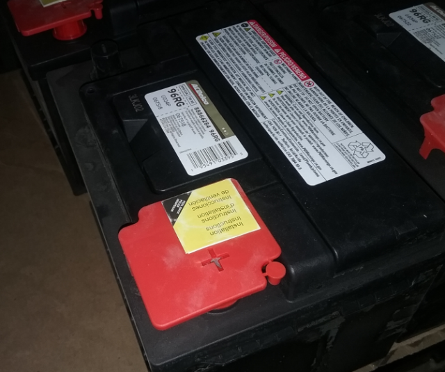

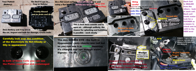

Battery Inspection:
This can be involved, use this only as a guide to help you navigate....
Wipe off any loose dirt - don't brush dirt into the cell covers - try to brush it out​
Gently remove - pry up and lift off the covers to the Cells - prevent Dirt from entering into the Cells - keep workplace clean as possible​
  • Look for
  • stains and "yellowing" showing the battery could have overheated or boiled (Erupted)
  • Low water - water spotting - heavy calcium caking
    • - meaning that the Acids inside the cells are now lower, less than ideal in Specific Gravity, use a Hygrometer as needed to check and to visually see if Plates are exposed to air - low/no water, boiled dry
  • Electrolyte cloudy or Oily - contaminated cells - replace the battery
  • - "GREEN EYE" not visible or more than one cell is dry replace (Recycle) battery
    • - it's safer than to try to replenish acids - the plates can be damaged and render the effort useless.
  • Gently inspect the covers,
    • look for Dirt or plugged holes note the condition of the covers and the areas they seal against
    • - high levels of water stains indicates tipping or sloshing of solution and leaked out of the cells to dry in place outside
    • - possibly from loose mounting or the WEDGE the Battery Size uses to keep it holstered in the tray may have corroded and now is gone, lost the ability to keep battery stable and level.
    • - Improperly seated caps and loose covers can cause excessive water loss and in some instances the Battery can freeze in winter and burst - causing the plates and case to crack - lessening the batteries usefulness.
  • Strong Odor the stench of acidic fumes - means the battery has leaked, or has gassed excessively - possibly from overcharging - inspect charging system.

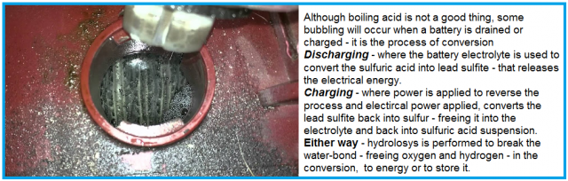

Rechargeable batteries - any Lead Acid - Nickel Hydride,Cadmium sulfide or even Lithium Ion...
All use some form of an Electrolyte that stores energy
- that also releases energy but in the discharging process - doing that conversion,
the bond that binds the energy is broken and is lost, most likely forever for that particular molecule,
but other free molecules in the (Electrolyte) suspension can then take up the released and freed
molecule restoring the polar charges from power used in the recharging process.

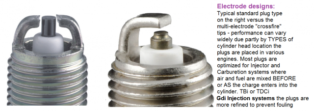

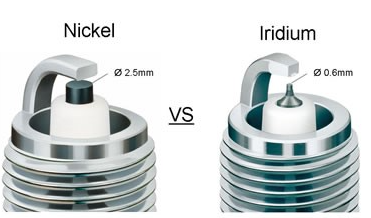

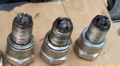

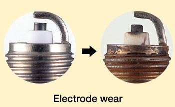

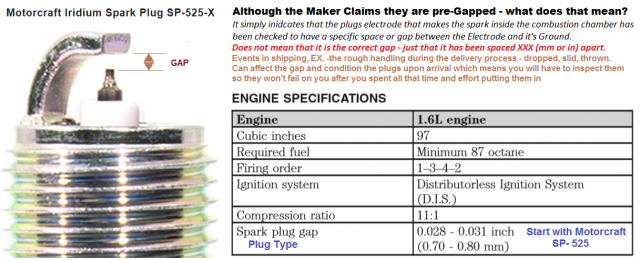

To help in selection:
The Go-To plug a dealership would use for a Spark Plug Replacement tune up is usually an SP-525 and base is COPPER, with upgrades to Platinum and Iridium as the type of electrode used.
Double tipped? Spitfire? Ring gap? Read their fine print - it could be that the electrode and its ground are both the same material. OR that the grounding tip - for the electrode - is split or designed in a ring to allow the spark to jump a gap across to the Ground Electrode in a fashion that exposes the spark in a greater surface area - not just to ground. To some enthusiasts - this side-arc gap is claimed to help the discharge to make a better, stronger, ignition source in the chamber by providing more of the discharges energy to be exposed in the fuel-air mixture in the chamber.
  • IN some views, the design of the vertical electrode gap is thought of as a hinderance, where the electrodes and their orientation have to provide a means to make the fuel-air charge mixture ignite so their position in the air fuel flow can hinder the plugs' ability to fire and fire well on a consistent basis
As far as gap, best to review the plugs you're replacing - you can review their gap and even see the change in gap distance that occurs when the spark plugs fire. Small amounts of molten core of the tip and electrode are blasted or moved from their location a process often called pitting - the heat of the spark melts the metal when the spark jumps and strikes against the opposite electrode. The migration of the metal erodes the tip, affecting the gap.
To me, it is a good idea to hold onto a set of used plugs until you can safely presume you have installed the new ones correctly. For if something were to occur, refer to the "rough handling" - during the install, you'll need to put the used plug or plugs in to limp the vehicle back to the store you got the plugs from to get a replacement.
As far as Electrode designs, the choice is up to you. But you do want the best or optimal distance from the cylinder head into the chamber for the electrode, as it fires, can ignite the mixture.

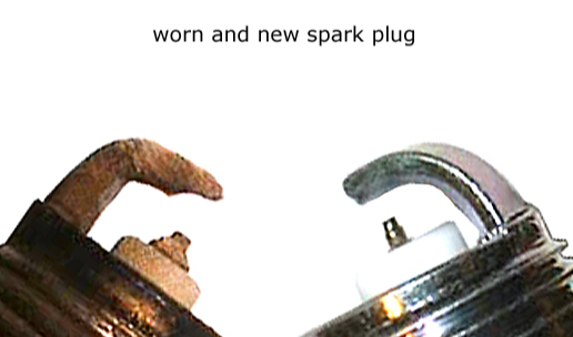

Look carefully at the Electrode Wear photo above, note the erosion.
I'm referring to it's tip...
Another closer look...
The tip of the left is what usually occurs when plugs reach the end of their useful life.
It's normal - the tip electrode is worn flat, and the ground electrode is worn to a point that the tip has eroded.

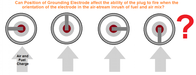

One thing to help remember - when you have a simple spark - even with a single electrode, the tips are absorbing the arcs heat - so the broader tip allows for the current in the spark to jump that gap, but the size or amount of the metal that electrode has, can play a role in how efficient the spark can ignite the mixture.
There was a time when it was thought that multiple electrodes offered more a means to ignite the fuel mixture. But as time progressed - the results were disappointing as the electrodes tended to get in the way of the mixture to even make the spark be seen by the fuel and air charge. Much of the arc was wasted energy that stayed too far into the spark plugs well, the area that is the gap between the Grounding tips and that center electrode. The Manufacturers went back to a simpler single-electrode design. - small high energy bursts are the preferred way to ignite a fuel charge in a cylinder. But an electrode that gets too hot can cause a preignition or spark knock you don't want. Thats power being wasted as heat energy - can cause a backfire condition, and if too early in the compression stroke, it can damage the motor. So, they made some refinements and made the tips of various alloys of rare earth metals to make them survive the internal combustion conditions.
Not just the electrodes but where they are placed in the cylinder - and how far in - depth the plug's threaded shaft has to project the electrodes inside - so they can be exposed to the charge in the cylinder.
That distance is called REACH - so if the longer threaded portion of the head is there, it requires the plug to also have the longer reach to meet into the cylinder head at the right height for clearance from the head, and to keep the piston from striking the plug damaging both the plug and the piston.
When it comes to reach, the Wankle Rotary motor has/had(?) a few issues around plugs and their ability to fire inside the combustion chamber.
One being that the combustion chamber rolled over the plug so it had to provide clearance and still remain sealed to keep the chamber integrity so it could fire the plug on the compression stroke.
So Bosch as well as other plug makers had to make a shielded plug so the roller bearing can roll across that area and let the reseal of the chamber begin for the intake So the plug had a short reach and short electrode entry.
So, in a way, the multi-electrode design has some benefits but
the drawbacks are from the inability of the charge-air to meet the spark
The Gap is simply too small to be effective.​

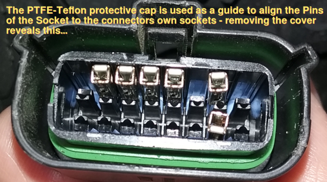

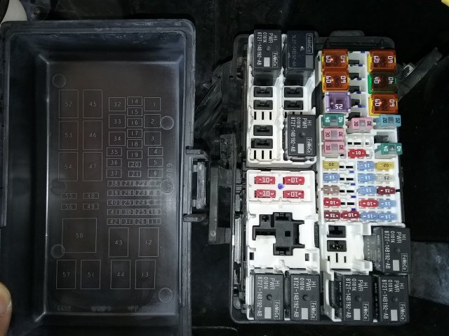

Battery Junction Box, a.k.a. the Engine Fuse compartment...ugh...
Ok, to help with some Relay info ...

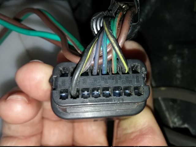

F5TZ-14N089-B unless you can read those numbers off the Relay itself...you might be able to save some $$$ by going to a local Auto or even an Electronics shop to locate the relay that follows that pinout.
The terminals can corrode, you'll need help with the TYPE of terminal that goes into that SOCKET on the plastic Relay card used in the box...
Motorcraft WT-1035 - Cheaper than FORDs own numbers KU2Z-14474-FA small, while larger lugs (Heavy current) are DU2Z-14474-GA ok?

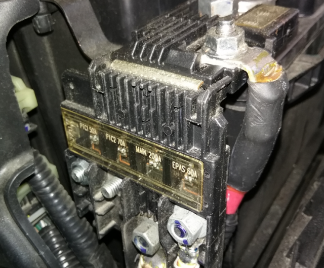

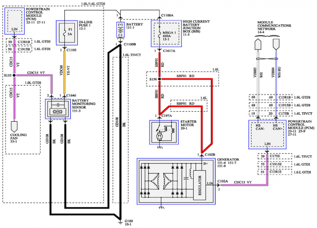

BJB or Battery Junction Box, is the Fiesta's' second in-line to provide breakout capability for power tapping.
The First one is on the main Positive Battery post - has Four terminals and a large 450amp fuse to handle the Alternator and the Starter.
When you remove it's cover, that red cover, the terminals are bolted to a buss - which distributes the Battery power thru the threaded bolts with each one having a fused bonding point.
In the above photo you can see - starting at the top​
  • - the battery post is bolted to the assembly - you can see the top terminal is fused with a 450Amp and the red wire to it is from the Alternator and Starter system
  • The Buss system then bends down to the side - starting from the Right
  • - which the side mount terminals bussed 60 amp EPAS (Electronic Power Assisted Steering)
  • - Main - 200 Amp
  • - PIC2 - 70 Amp
  • - PIC1 - 50 Amp

The Vehicle is new (to me and SOS) so to have this happen and how the Dealers' non-resolution resolve - comes into this a separate beast for it's own, which is beyond my response to post this...
So what you're seeing is my rework...
The Ambient Air Temp sensor is on the Front Skirt by the Snorkel for the Air Box.
I was helping in the thread and since this kinda' reopened an old wound, I figured I'd better do up a post or two as a Salve to ease the effort for the next guy...
So - let's cut to the Chase...
That's it!
a roughly $7 sensor​
I took apart the Battery tray and cleaned out the road salt and inspected the tray, holster and made sure all wiring was still in good condition, which requires removal of the Air Box, Snorkel, Air Intake hose, and Left Front Headlamp.
This is so you have clearance to gain access and remove the Battery tray and Battery - check and clean neutralize the acids and inspect, check level and top-off the OEM Battery water - just for a measure of prevention.
Back to the task...
In this view,
The Sensor
NEW Part Number!
Once it's put back together - it looks like this correctly mounted...
Reassembly required...
Put you and your car back together as you see fit...

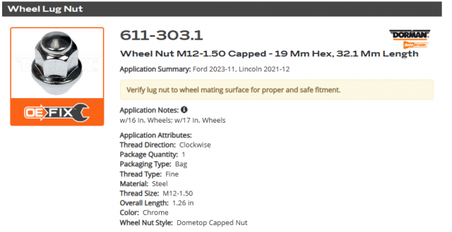

Ok, gonig to add some more info for those that may want a quick reference for parts and the OEM...
ACPZ-1012-H or CV6Z-1012-C
That's the Ford direct reference to their Lug Nuts for the Fiesta and Many other vehicles - possibly all the vehicles listed on this site can use these...
Ok, sizing matters so they are...
For ACPZ-1012-H
19mm Hex Size - (For Lug Wrench or socket sizing)
M12 - 1.50Pitch - thread size
Minimum Length (for fit thread stud length to cap top or thru-hole open end)
Seat type: 60 degree conical - or Acorn Bulge seat - varies due to rim to stud seat type
Capped - 32.1mm
  • The above length are for those that have Wheels that do not require wheel covers.
  • Can be used as needed for all wheel rim sizes - this includes 15" wheels if the Wheel cover is not used - as if Basic Steel Wheel 15jJ X 6

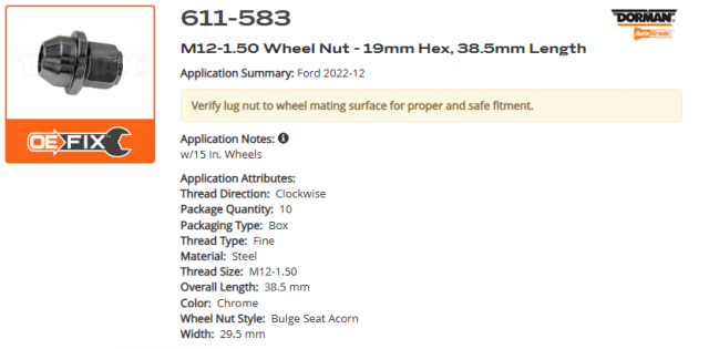

Open End or capped (shown) - flanged for Wheel cover installations - 38.5mm CV6Z-1012-C
  • Open-end ones are for those that require a wheel cover that Ford provides - where the Wheel Cover is placed on the wheel then the cover uses the Lug-Nuts to hold the cover to the wheel. The nuts go over the wheel cover and are exposed.
  • these are also recommended for 15" wheels - Check application first
Bulge Seat Acorn(1) for non-covered wheels or Conical 60-degree style for specific rim styles.
  1. Bulge seat Acorn style starts as 60-degree conical then flares out wider than the Hex Nut size

Longer style that is used for attaching Wheel Covers to the steel wheel when it's mounted to the hub.
Ford Direct cross references CV6Z1012D
The above is for starters, but the main premise is if you find a style of lug nut or type of nut you'd like to feature - the basic size is 12mm x 1.50 Fine pitch with a minimum length of 32.1mm and if lug-held covers are used - the minimum diameter of the flange (width) needs to be 29.5mm - pretty much all Ford Wheel nut types are 60-degree conical - with Bulge seat being that it starts out as a 60-degree conical then flares to the larger than Hex nut - size - as the more common type to use.
If you are interested in Wheel covers, for 15" wheel - Ford interchange is 7054, but Ford direct part number is D3BZ-1130-A

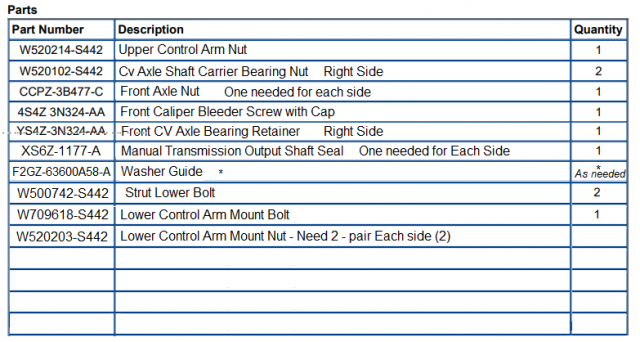

Front axle work - bolts and nuts of the problems - or problems with the RIGHT Bolts and Nuts for fixing the Problems
Another bolt to remember
Ford 7N5Z-00812-A - a 16mm X100mm bolt - this one goes thru the engine subframe assembly - thru the Lower Control Arm Bearing - into the Body
Strut Bolts...
Ford W715490-S442 a 12mm X 50mm bolt - for the struts.
FoMoCo numbers...
Strut Lower Bolt - Ford (W500742-S442)

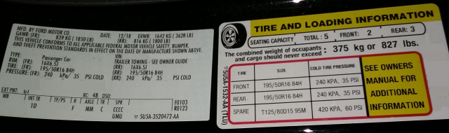

#Tire Size
Tire and Placard, Rim Size and Type - and other Nomenclature...
Those whom own a Fiesta in the USA have these stickers in the Drivers side Pillar and Door Frame,
The things you need to pay attention to are highlighted...
The sticker on the left...
Rims are 16 in DIAMETER x 6.5 inches WIDE using J offset
(referring to) the rim goes under (or over) the hub
- tire tucks under and aligns to and with the steering axis and knuckle​
The sticker on the right...you don't need as much info - just the load weight that is EXTRA - because it will affect the ability of the Tire to handle the weight - be it constant (typical load) or the rated capacity (extra or Heavy Duty cycle)
Arrows show that extra weight - the Gross Vehicle Weight Rating (GVWR) will include
- the weight of the vehicle without it's occupants (empty)
- and expected MAXIMUM weight of added load - being passengers and cargo
- The also list the maximum weight per AXLE (FR = Front) (RR = Rear)​
  • This is to help you understand some of the numbers and how Tires and Rims you got for your vehicle affect your performance and in some instances - your replacement tire size you might be forced to use and to replace damaged Rims you may not be able to find replacements for - which between those two options - you'll need the above information to help you help the dealer, and/or service department - move forward in fixing your vehicle.

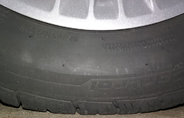

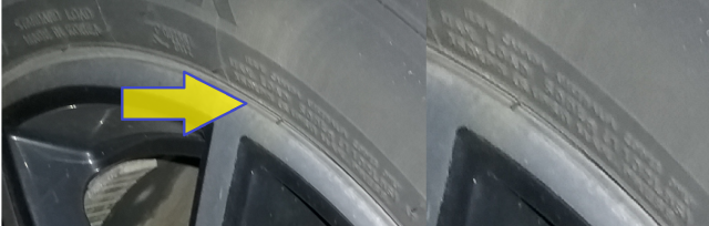

This is a salvaged pic of my older tires (Optimo).
The size was 195/50/R16 - Spoke rims
The arrow points to the Sidewall of the older tires load rating
That being 500kg, or approx 1021lbs.
A tire, even of correct size, might not be able to hold up the weight of the axle with the cars' own weight bearing down on it. The car may be empty but does the tire meet that Weight Load standard? If it can't or barely does, get rid of that tire type - use a tire with proper load limit rating - slightly above is better than being BELOW the originals standard weight load rating.
How do you know what that "Standard load" is?
Look on the Tire - it has it embossed on the sidewall - in both kg and lbs - like shown above or here...
This is the newer set on Steel rims (BF Goodrich Control Advantage)
A closer look...
These are from a Tire Size of 185/65/R15
I see 560kg or 1235lbs.
And a pressure rating of 44PSI max for inflation.​
Ok, the fuss is for you to know how to find that load rating - and use a rating that is as much as (equal to) or greater than, that - of your original tire load ratings.

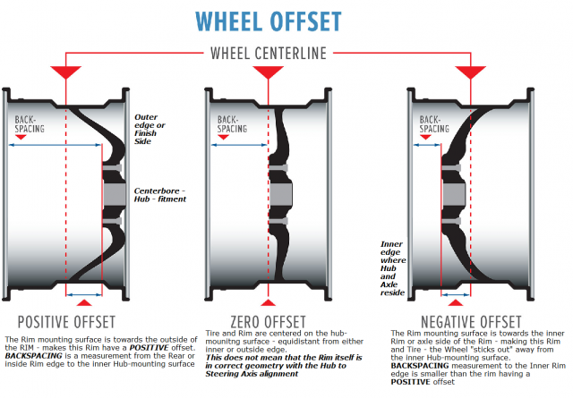

Wheel Offset is simply a measured distance from a Rim's centerline - to where the Flat surface is that you place on the Axle Hub when you put a tire on your vehicle.
Don't need to make it complex, that "offset" helps the Wheel (Tire et-al) contact surface to the Road - stay in a spot designed by the Maker. This "spot" is usually, Right where the Steering Axis (your tires point of rotation to turn or steer the car) is located, usually just below the Steering Knuckle.
What makes it complex is due to the Aftermarket - A Fiesta is originally designed to use a Rim of 15" or greater, in a "J" shape (Refers to how "sharp" the Spokes or Rim mounting surface shape or flat and square to the Rims edge)

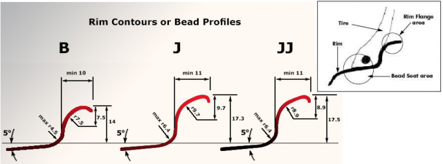

The "J" designation helps determine the type of seal that Tire Bead or Shoe rests on,
And how it rests on the seat to seal the bead.
This also helps explain the reasons why WIDE tires of larger "P" -Size values
when they are put on smaller profile - or narrower rims - cause problems.
Same can be said about Smaller - P-value tires
- too narrow of a tire on a too wide of a rim, can not only cause a seal rupture
but a failure at an inopportune tine and cause a crash.

See how they put in the Rim size? Locate that second placard the one with the GAWR - note the "J" and the size?
Then note the size used for the SPARE.

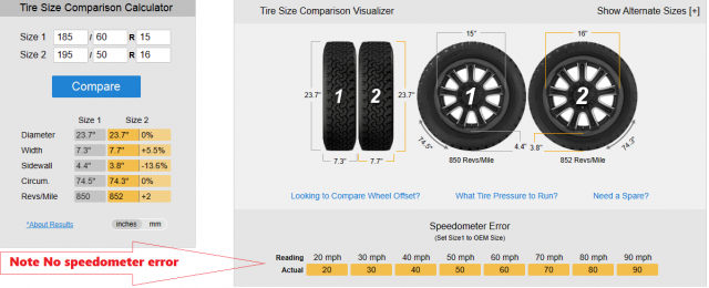

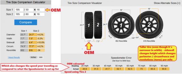

Easiest way is - measure your tires from side to side - right across the centerline of the hub to find the diameter - should be between 24.5 to 23 inches - this is your best size to give you your torques and speeds and proper speedometer measurement of speed you travel along.
IF you need help understanding this - go here

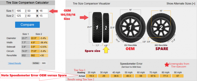

When tires of about the same size are used...
Note the Speedometer error - there is none.
Here's a visual example - the sizes are CURRENTLY being used in my own Fiesta - so this comparison only deals with sizes to make the tire about the same size in both perimeter and diameter - but road surface contact patch is different.
But...
When they are different sizes - like to obtain ride height
note the differences!
Tire 2 may be a NARROWER tire - but it's sidewall - being a 60 series,
changes the sidewall height and also the ride height. OEM is Less Height and has a Wider tread.
With me so far?
Let's try my SPARE TIRE size to get an idea of how drastic this can get...
Tire 2 is is the SPARE TIRE size
- and so the comparison becomes how you think how fast you're actually going
versus the systems own thinking on what speed you're at, using the OEM size.
this is done to help demonstrate a point.

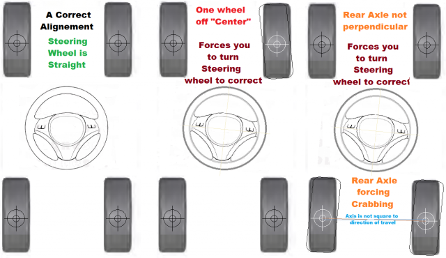

The Offset is used to help the vehicle follow a track and stay true to it - to do that; requires the tire and it's contact points or patch where the tire meets the road follow the alignment track. If the Offset is not right, the tracking the vehicle will make - will also be impacted. So all the vehicles tires need to roll along in the same fashion using the same offsets and tread designs to help maintain the vehicle rolling in a straight line and/or make turns without severe impacts on the steering assembly or to make the turns difficult for the operator to perform and complete.
To help - if the vehicles alignment is set up to have the contact patch set right (the pivot point where the tire rotates exactly over the spot) at the axis of turn, then use a wheel rim that places the tire away from that point - using an Offset that alters where the patch rests - will also affect the steering track and how rough impacts from uneven pavement can damage the steering system and overall; affect how the vehicle will perform in handling.
The Contact Patch is a spot, simply a pressure point - the tire presses down and the road presses up - between the two you get the friction coefficients - for the amount of friction at any given time and condition can change the ability to steer, brake and even stay on the road.

Narrower tires are also problematic. If you use a size not able to handle the road surface, you can lose the ability to continue to drive on the surface and the vehicle will sink into it (mud, sand - even snow) and by the weight of the vehicle will place on the tire at any given moment - could exceed the rating of the tire and cause a premature failure.
  • Yes, I said snow, but when you are on a flat pavement road surface that is hardened with ice and the snow is on top, you can toboggan over the snow, and lose traction - on wider tires.

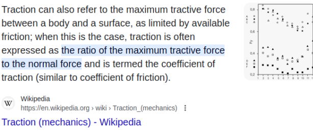

    • Less traction on wider tires?
    • Yes, if you deal with snow and or rain - the larger broader surface the tire bears weight down on - can reduce the traction by having less weight over the area in contact with the water that is laying on the surface of the road.. The tire would or could "float" on the "Surface tension" that the water would have. This effect is greater on larger contact areas than smaller or narrower tires and "knobby" tread designs that have less surface area
    • On snow, the grip of snow has a coefficient that is much less than 1 - more like 0.2 to 0.3 - a 70% reduction - so the contact patch itself needs to bear down weight on the area - which helps multiply that factor as a means to provide traction
    • Less friction caused by oil and other fluids like coolant and brake fluids that can be left behind on the road, mixing in and making a type of "soup" that can lessen the level of friction to more of a like coefficients closer to snow..
    • On narrower tires rolling on rain wet, slushy or wet snow roads, the vehicle can use the tires narrower profile to form more of a set of skis that - while you have less width for contact, the skiing effect lets to steer and maintain some form of control when the snow is letting the tire sink. Smaller accumulations or low levels of wet heavy snow can actually help the vehicle to steer by providing a force much like a rudder to help the tire maintain a track thru the snow.
      • Partially the reasons many people get the vehicle stuck in snow, is due to the lower profile the undercarriage - gets the vehicle stuck in the snow, by increasing the drag - you don't have any true clearance.
      • Trucks use the wider tires to handle their weight, expected load, and road height - passenger vehicles don't, or at least they are not built for high profiles nor for that type of challenging terrain trucks and SUV's are able to drive on.
        • Remember, It gets more expensive as you go higher in profile and terrain demands that force you to use a vehicle with higher road height and clearance.
  • As with any choices, you have to determine if the cost of driving with wider tires versus the narrower width - affect your ability to control the vehicle.
    • As said earlier - you do not need to make large changes to affect the effectiveness of the tires and the tread you choose to use. Large changes can seriously hamper your ability to drive and control your vehicle.

A Bright spot to your day - keep your (Tires) pressures up -
As you may already know, when the air gets cold - it contracts. Ever notice a balloon filled with Helium - it floats on the end of the string, one of many a kids favorite toy. Did you ever notice that when you take it outside in the wintertime - it can seem to fall and deflate?
Cold temperatures affect gasses and affects their volume - even though it is the same pressures, the volume it takes up - shrinks. So in a way it's density (not pressure) increases with the drop in temperature - to a level that the balloon loses it buoyancy due the displacement it had at a higher air temperature (less density per cubic volume) - even though the gasses have not escaped, they've simply have been reduced in volume affecting the balloons displacement of the heavier air gasses around it - changes it's buoyancy. This is simply a type of contraction caused by the gas molecules losing energy to keep the balloons skin surface stretched out to displace the air gasses outside it. So it's own weight in gas and the balloons own weight in stretched skin - changes its size and loses it ability to float - even though the pressure is the same - the volume is reduced.
Which - by the loss in volume, that change in density - then makes the pressure inside the tire appear to drop.
Which is the reason for that sub-header...
TPMS - It's Air Pressure - not your Blood Pressure...

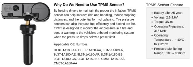

Relax. TPMS was designed to help you recognize some dangers when you neglect your tires. Which, damage can result - that will raise your blood pressure if you forget to maintain one of the many important pieces of your transportation - your wheels.
So What is TPMS?
For Tire Pressure Monitoring System.
Looks like one of these little guys...
Remember - Prices are subject to
Change!
Just from 2019....
The above is to help you locate parts by FORD OEM numbering and may be help you find their TPMS Motorcraft offset - perhaps TPMS 12 - but no guarantees - for the system the TPMS uses is RF based - so it uses a signal from one - to talk to another which then brings up regulation of the airwaves used, so the means FCC ID stuff which can affect the ability to these TPMS to be even able to talk to your cars transceiver.
So Frequency is important! Remember change is inevitable for they may have made changes, in the range or bandwidth of frequencies used in the model years this was made - so it can be at 315MHz or 433MHz - either way - check with your dealer or retailer you're buying these from to make sure you have the correct frequencies used in your make and model year.

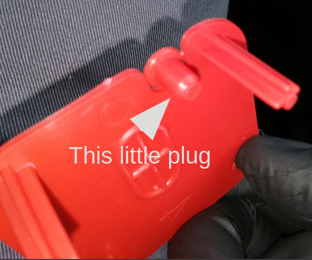

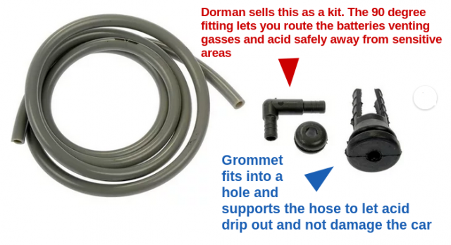

Putting this out here in this thread as part of a "heads up" you may encounter.
I'm sure you've seen these
Yeah, it's a battery but see that Red cap?
There are several types of these caps that cover the RED post of these
types of batteries.
The part I'm referring to is that red button.
It is a plug designed to keep the Acid inside the battery from ruining your car.
This post is about those that may have to search quickly for a battery that will help them get to better help or away from a condtion that left them stranded - like a cold winter day and it's a blizzard outside.
So when you're faced with few choices, you can find a battery with RED to the right post orientation, like the ones above, but if you come across that type of cap - be careful and use them per their instructions.
Some even come with a fold out to help you.
IF you can - you can also buy a kit to help you re-route
the corrosive venting gasses and acid away from sensitive parts
and let it safely vent them away.
Just be sure to examine the venting system carefully for the next week and look for drips of acid on the floor under the car - it may mean the battery vent tube is SIPHONING the acid away and you may need to re-route the hose and venting system so it does not drain and siphon off all the remaining acid​
  • Why? That plug is designed to cover one of two ports for a vent system - it also prevent Acid from making your day and ruining or at least spilling onto, the wiring harness located below that battery mounting shelf plate.
IF you use the battery tray, great - you can leave these plugs out but look out for the clearance height on the case. The Battery can be too tall and can let battery vent acid into the engine compartment and as your driving, remember it is charging and producing gasses and venting small levels of sulfuring acid vapors (that smell it produces during charging) it will spray onto parts you don't want it on.
Again this is for batteries that you have to remove the tray in order to get the battery in. That plug will help keep any venting acid from dripping out into the air stream coming from the grille and radiator fan blowing air - it can form a spray that will coat the inside of the engine bay and possibly shorten the life of any exposed wiring and metal parts and fasteners..

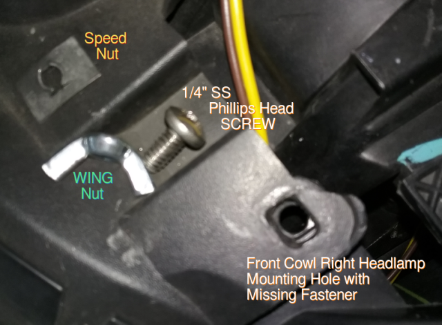

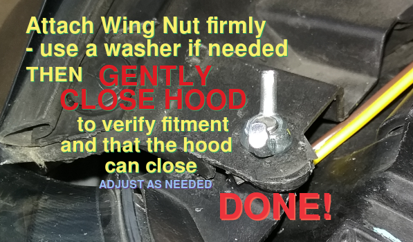

This is how I do it - maybe this can help others - sure you can try to find Plastic replacement hardware but will it last?
This post is to help others trying to find solutions to making a type of fastener so you can easily remove the part so you can replace what is inside it.
In this case - it was my front Headlamp - one side lost a plastic fastener that was 2-piece with an insert that expands to fill and make a snug fit into a hole using another piece that looks like a plastic version of a simple tapered screw.
So let's just start here - and introduce the characters...
  • It's a pretty simple list...
  • 1 - 1/4" SS Bolt - length about 1/4" and I use a Phillips head stainless steel type with NPT.
  • Speed Nut to fit 1/4 - thread bolt - normal pitch (NPT)
  • Pair it with a Wing Nut to fit the thread of the bolt and it's pitch. (again - NPT that fits thread of Bolt)
  • Then I; Disconnected the Wiring and Removed the Headlamp
    • Note: The #30 TORX screws are intact but the Cowl plastic fastener fell out of it's hole so we are just putting a simple fastener together to make the Headlamp more durable.
  • install the Bolt threaded side up and use the speed nut to sandwich it to the EYELET
  • Notice the Nut forms a smooth and flat mounting location for the COWL side hole for fit and support.
  • Also make sure the Headlamp once mounted - you can bolt the TORX bolts to mount the headlamp and make sure there is NO UNDUE stress on the lamp caused by misalignment or over-tightening of bolts in the mounting holes
    • - the loss of a fastener was due to age and vibration of driving the car so the fastener was weakened and the hole enlarged to a point that the fastener couldn't even hold itself in - it fell out
  • Re-attach the Headlamp wiring Connector and install the Headlamp - align holes and holster and attach the TORX screws...
Hope this helps!

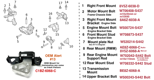

Engine Mounts:
Or - "Mairzy doats and dozy doats, and I'll be home for Christmas. Signed, Your loving son, Queen Victoria". - Col Flagg MASH 4077

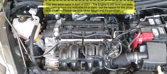

Although most of the vehicle lifetime has been spent just carting me around I've encountered larger and larger volumes of problems and quirks I never experienced before in former vehicles - this includes a type of event like "bump steer" and torque wander - which both are related to the Geometry as well as Design.
OK, while on the road - I've been noticing my vehicles engine noise getting louder and louder thru the years. It was getting to a point that it was beginning to affect sounds and the volumes of things I've had to turn-up or turn off to bear with this noise from the motor and transmission - let alone the increased road noises.
That's where I found the Motor Mounts as part of this problem. As they bear the loads and sit in the engines bay they are subjected to the typical driving needs and heat/cold and seasonal effects - they all add wear and tear to the mounts that support the motor as a whole - in both the Chassis and Engine and Transmission and even the Drive-axles to transfer energy into motion.
There are three...
I came to writing this post due to what I found under the hood when it time for Spring cleaning up and having to replace the OEM battery after it served faithfully for 7 years. It would have stayed in the vehicle had it not corroded the Battery terminal post connectors due to bad post to case seals - vibration possibly the culprit - to a point where I said - OK, that's enough.
$180 later, I had a new battery and had also the chance to investigate the leaking condition from the top-post terminals and how it flowed in the battery tray and onto the cars transmission hump and any place else under that tray.
Here's out it layered out...
The Battery did it's job. The acids inside it were still viable even after 7 years - so leaks from the top posts meant it had reached retirement. So, took the Airbox off, snorkels and all hoses PCV and Foul Air Purge vent lines - removed the hardware the battery used in both hold-downs and Junction box, note in the Photo above the top-post adapter was removed later - it was purposely done so I could inspect and clean the battery to junction box bolt and connections to the battery.
The Battery tray and the Tray mount were a little more involved and required some time for cleaning - once done I also inspected the "bay" the tray and plate left behind - where I found the Transmission side Motor Mount.

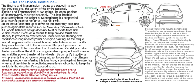

Now, most people would not know what to look for - and when you look at any Motor mount - it is a steadfast - sealed in rubber -unit that doesn't really look like much until you take it off the car and inspect it by applying forces to where those bolts and nuts went and see what happens to it.
A new Motor Mount is stiff to hands trying to make the bar or mount twist and move. Compare that effort on the older ones on the vehicle. Once they're removed - under closer inspection you might see metal brackets dipped in Rubber with cracks, tears or broken seams. Or corroded and rusted brackets being exposed to stresses, heat and vibrations. It is when you twist and press against it, using your hands - does the weaker mount become noticeably apparent that it doesn't take much effort to make this mount move. The Motor and Transmission as one assembly weighs in nearly 350lbs in itself - so that translates to tell you it's time you replaced that mount with a newer one.
But there is more to this story - and that deals with the residual torque you have when the Motor/Tranny as one whole assembly is bolted down in the car - it may have torqued itself into a twist that can make the Motor mounts holding it in place fail faster and introduce variables in the drive-line and steering you don't want. When they put it together - they don't do much to "align" anything except to make sure as many bolts and nuts are tight and the wheels point to the front and the worker can drive it off the line and park it so they can ship it somewhere and you're caught buying (what your eyes behold as) the beauty as if it was purposely made for you.
That "align" is what made me inspect the engine more. and I found by using a bubble level on the Valve cover, the engine tilted, dropped to the right. The slope - where the tranny was lower in height to the engine, was considerably noticeable. I compared and measured the slope - even to my own photos I took of the Engine bay when I first got it. Yes, quite a sizeable slope or dip was forming. So knowing I had acid leaks - I placed a lift jack and using block of wood - under where the Motor meets the Transmission (Clutch area Bell Housing) and took to the task of seeing where or how much of a lift was needed to bring the assembly back to level. Not much - about an Inch of lift but under the car is where I discovered the purposes of that lower dumbbell shaped Motor Mount was, how it worked and how the engine tilted around it as I raised and lowered the transmission side of the Engine and found that BOTH upper Mounts were tension-ed - possibly all the way back to the time it was built at the factory - and were left in this state of constant pressure on them.
Now granted the engine and transmission are supposed to place their weight on these Motor Mounts - it's designed that way. But as the vehicle ages the weight and balance the mounts provide will change by age and deterioration of the medium that the Mounts use to support weight. They get softer and softer and with my battery leaking acid, they can easily get softer and even split and fail sooner than later in the lifetime you own the car. So - again, it had to be done.
Below is many of the parts used for the Motor Mounts - many of them can be inspected and cleaned up and even reused although its is suggested that you replace all their hardware with new when you replace the Mount - the older Hardware can be used if you are willing to accept the responsibility of failures that may occur when you use used hardware - so you've been warned.
In the above diagram - they show many of the mounts have more than the "mount" itself - that some come as inclusive with the Bracket and the Mount together and all you have to do is remove the bolts from it and the Chassis and Motor Assembly - and the new Mount just bolts in to replace that which you took out.
  • However, there are differences. So you may need to use your Vehicle VIN to help find the specific Mount part that has the right configuration.
  • ...And if you need to change transmissions - the #15 part will have to go onto the new transmission due to it's plate configuration needs to match the Transmissions Motor Mount Bolt pattern and clearance spacing.
  • TOOLS YOU WILL NEED...
    • 18mm and 15mm Deep Well Sockets
    • E-12 External Star (Torx) Socket for Front Engine Mount STUD loosen/removal as needed
    • 18mm (19mm works too) Box End Offset or similar wrench (Open end OK too) to help loosen Mounting Nuts
    • #25 Torx Driver, 10mm, 8mm and 7mm Nutdrivers to help remove Snorkel, Airbox, and Battery, hold-downs, Terminals and cables and the box; with 6" Extensions to help with reach as needed.
    • Floor Lift Jack and Blocks of Wood to support Engine (Motor and Transmission) Assembly
    • Anti-Seize compound and Thread Sealant compound can be used to help reduce corrosion and make installation and later removal for inspections - easier.
The Hard part? Support the engine and tranny with a Floor jack and blocks of wood to prevent it from sliding out. Don't try to let two mounts try and hold the assembly up, remember they too are aged as well. If you don't use any sort of floor jack support or blocks of wood - all that weight left on the weaker Motor Mounts can give you disastrous results- even breaking the existing Motor mounts and leaving you with something on your foot or pouring oil onto the floor of your garage making a mess an even bigger one.

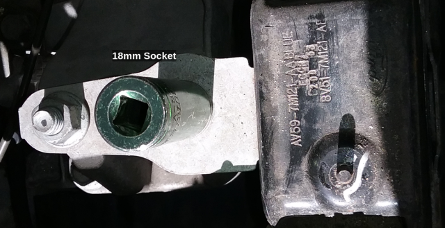

Inspect the Front Engine Mount - note the "Grommet" that bears the load and shake from the Engine - note it has a corrugated or wavy pattern on the Mount side - this is an indicator for you on how viable the Mount may still be.
  • This is why I mentioned earlier - the Mounts may have been put in and left in a state of tension or pressure caused by the Factory Install or Age and settling. The Mounts can handle considerable pressures, but if left in a constant state of twist or tension, their media will tear and fail - making a clunking noise every-time you shift or turn - with a lot more noise than you're used to. And you'll have to replace it anyways.
The Mount base may have some surface rust, inspect the welds, Bolts and braces to the Chassis - in my photos this Mount is the next one to get replaced as time permits. It's pretty rusty. But the media is still good.
I found that by loosening the locknuts - the studs will also turn so just use an E-12 Socket to remove them with the Locknuts left on the studs - one at a time to inspect and remove any tension - while using the Floor Jack to brace and hold-fast the engine side while you remove these studs. I cannot stress this enough but using a Floor Jack and wood helps keep you and the Motor safely away from each other and prevents damage - let alone ease of reassembly.
Beware of alignment - you may need to use the Floor Jack to lift or shift the Motor assembly (even two jacks as needed) if you choose to remove both E-12 Studs from the bracket to re-align and reinstall the Mount. It may be necessary to loosen the Tranny Mount to assist with this re-positioning. You may have to do this anyways to reposition the Mount so it can operate without having it's media twisted or crushed by improper alignment previously done causing this condition.
E-12 - Torx'd Stars - Not just for School Anymore...
Using an 18mm Socket and E-12 Star Socket - Loosen the Locknuts then Torx off (using the E-12) the Studs with their Nut to remove. Keeping the Nut on the Stud helps you determine how far the Stud needs to go into the Bracket - as a stopping point for insertion depth for the Stud. You don't have a lot of room under there.
Please do not try a shortcut and take off the 15mm Bolt on top of the Mount, it's in Rubber and will break off internally and then you'll have to replace not just the mount but possibly that Bracket too. The reason for the Loosening of the Locknuts then Remove the Stud/locknut together- is due to the Nuts and age of the Mount and it's Hardware - easier to re-install with the Locknuts at the proper heights than to try and seat and fit the Stud blindly without knowing how far to turn the Studs to ensure complete insertion into the Engine-side Bracket. Once the Locknut meets the bracket when you tighten it back together, use the E-12 Socket to assist and a 19 or 18mm Wrench to tighten the Locknut at that proper depth into the Engine Bracket.Then if you choose to replace the mount - using a 15mm Socket, continue the removal and remove the 3-hold down bolts for the Mount itself - installation is just the reverse of all you've done. Chassis mount side first, then Engine bracket side using the Floor-jack and the Transmission Mount re-positioning to help re-align all the mounts so the design doesn't twist when you remove the support.
  • The Overflow Coolant tank can be gently removed or re-positioned - lifted off so you can get access to remove all three bolts to the Chassis side under the Overflow tank. Remove the Bolts and lift the mount out from the front side - you will have to remove the right front headlight assembly to obtain enough room to do this.
  • Once the Mount is off the car, you can then determine if you wish to "epoxy" the rubber or what's left of it and re-use the mount. With it off the car, you can re-seal and fortify (Harden) using Epoxy, and with some disassembly - fill in gaps to help stiffen it back to OEM condition as least to offer a temporary solution to save money to get by until you can replace it with a newer one.
  • If Money is no object; you can replace the mount entirely or possibly save it and some money and reinstall the Mount. You can reinstall it and even reposition it - so it doesn't have to be twisted - increasing it's life and quieting the noise.
    • There are offers on some On-line websites that let you purchase Polyurethane shims that can fit this mount once that 15mm center Bolt is removed. This changes height during reinstall so be careful on positioning this for the other two mounts will also receive extra tension from this upgrade - if you with to take this route.
The Rear Motor Mount, the Dumb-bell one - is the only one that doesn't need a lot of floor-jack support, although you don't want to trust that the upper two mounts will keep the Motor and transmission from swinging back at you if you're not careful. So use caution and common sense when it comes to safety under the hood. Safety glasses too - there's bugs, dirt and opossum leftovers caked in layers down there so keep your eyes safe and clean - at least keep them that way.
I'll add to this as time permits - take care - be safe!
