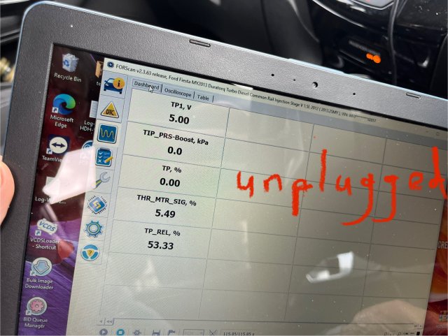

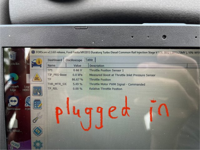

Hi folks, I'm attempting to get the bottom of a problem with my dad's Fiesta 1.5 TDCI (2013). It hesitates in 5th gear even under a small amount of load, but not at all in the other gears. No codes in Forscan. Does it every time the car is run. I've run some live data while driving it around, and it mostly seems to look normal to me (although I'm no expert). That is, with the exception of the throttle position sensor. I'm getting a constant volt reading on TP1 of 0.66v, and a constant throttle position of 86%. Neither value change at all at any speed, including idle. (see attached image.)

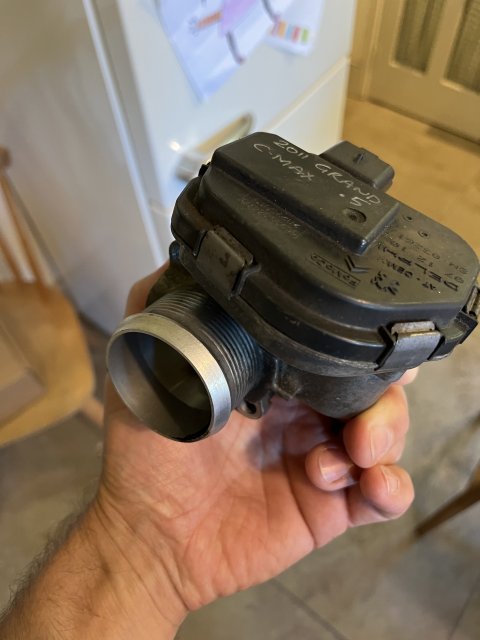

So I got hold of a second hand throttle body and fitted it (part 9673534480), thinking that might do the trick (the sensor is in the body), but it's made zero difference. The only time those values change is when I unplug the sensor while Forscan is reading the values. The the voltage changes to 5v and the throttle position goes to 0%.
I'm thinking maybe it's bad wiring? Bad ECU? Has anyone had any experience with this, and if so do you have any advice? I own a multimeter, but I'm not knowledgable enough to test the wiring in the harness, at least without some guidance. Any help hugely appreciated. My Dad's driving around everywhere in 4th 😫
