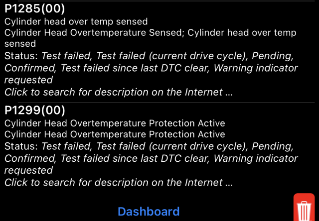

2016 fiesta ST
For some context, I am rebuilding a 2016 ST that was modified by the original owner (who died) so I cannot get any references to the modifications he has done to the car. After plugging the battery in and putting the car in acc position, the temperature gauge rises even before starts up. I had already checked a temp sensor on the car and seems like it is in a functional condition.
Is there cylinder head temp sensor that is I don't know of, because I am about to give up and send it to a dealer :(
First, this is an ST that the previous owner died so that means no way to find out why this even happens...?
Ok, presuming the sensor is good, did you pull the connector and check for a voltage going to the sender?
To see this going on in the ACC position tells me the Original owner modified the vehicle and it's powering the PCM before you power up the car (Start it) - so yes, quirks like this are going to show up - including a set of mods that let the cars cooling system fans run a few moments longer to cool down the car and the turbo. When he sets up this mode after his drive.
This kind of leads me to think the owner ran this car hot a lot of times and needed some way of cooling down the system - so he forced the PCM to "stay up" and ACC position is where he set this up to cool down the car so he could even open the hood and not get burned after he let it run a few minutes.
This may also indicate that something in the PATS system is aware and is trying to shut down the car or put itself in a "limp mode" so someone trying to steal the car - knows it won't run very well for them.

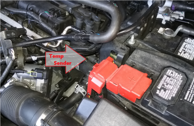

Thankyou for your quick reply. For the first question, the previous owner did some modifications to the engine. For what I can tell by looking, there is an aftermarket exhaust and cobb parts that is in the engine bay. I unfortunately cannot find any receipts nor records of modifications he has done to the car.
I did not check voltage, but I swapped the coolant temp sensor with a known good one but still arrived at the same results of the car thinking that it is overheating. I noticed through the DTCs that the cylinder head is sensing that it is "overheating." Is there a temp sensor for the cylinder head? I had looked through the repair manual and cannot find anything related to the cylinder head temp sensor
There are others here that own ST's - I was hoping they'd chime in to help...
But to continue in the thread - the sensor, if you swapped with another and still get the same results - tells me there are even more questions - but to continue - the sender (the one on the cylinder head) is over by and just underneath the spark plug coil pack.
Is that the one you already checked?
There is a thread or two about this - here...
https://www.fiestastforum.com/threads/cylinder-head-temp-sensor-location.23475/post-397704
And it relates to an issue with the wiring and harness failure - which would fix this problem too, if this does apply.
That fix of the harness and it's returns - the results you get are similar - means that the drop across the sender is not getting back to the PCM to determine the actual temperature the engine is at. So that would put it in limp in mode and prevent the vehicle from being driven - even normally. So this may mean the voltage check needed - may also include a type of loopback test where you backprobe the sender to see if the sender can return a voltage back to the PCM thru a process of loading a known reference and altering it's output (Bridge network) as a means to fine tune the Air fuel charge just right per the MAIPT (Manifold Intake Air Pressure Temperature - amongst others) and the reading it gets from this sender.
Backprobe is to test using test leads of a style and type that lets you clamp onto the electrical wires to view the results on a DVM setup designed to test the signal or voltage results at the sensor itself - while it is in operation.

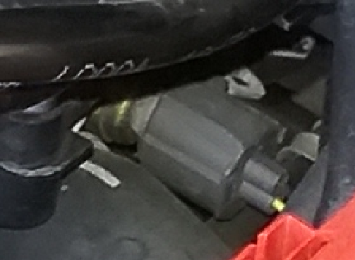

The sensor in the photo you provided is indeed the sensor I replaced earlier. I will test out the harness and will keep you updated!

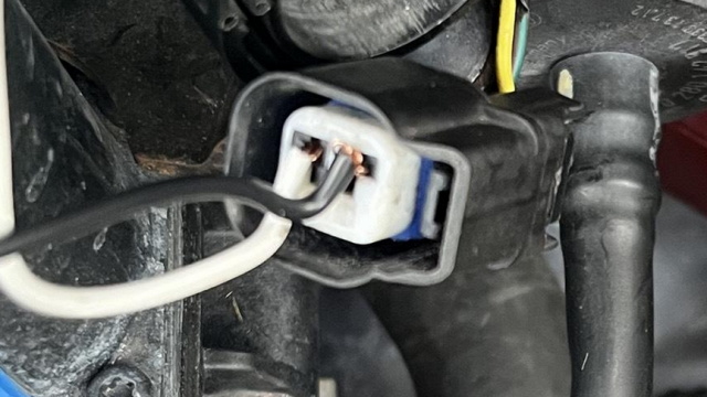

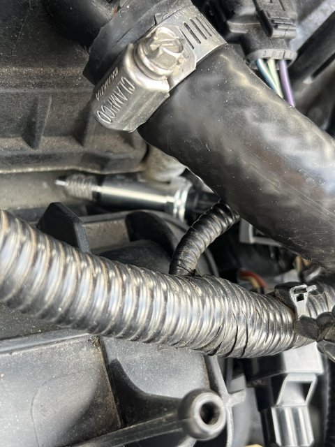

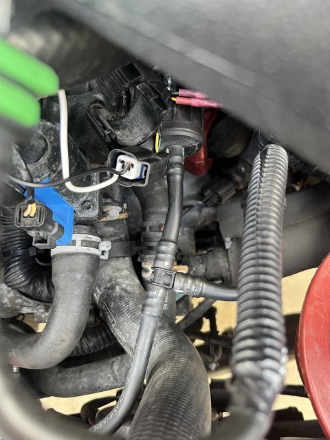

Update: I ended up replacing the sensor and its connector, but it did not fix problem. Rather, some rigged solution ended up fixing the problem. Idk what this sensor is, but plugging the bare wires into this connector ended up fixing this problem. Maybe this sensor/connector is needed to complete the circuit? Idk, at this point. I have an urge to hardwire it and call it a day lol .
View attachment 8850 View attachment 8851
does anyone know what this sensor is? the connector you wired it to is plugged into some kind of sensor right in front of the ECT sensor but i cannot find anything on this silver sensor you pictured. Im also having the overheating issues you were talking about and im thinking about trying to replace this sensor next. Once i figure out what it is at least

Looking over this thread - I wanted to point out something...
Note this is an OEM connector - but the grommet and it's color are what I wanted to show...
Note the blue of that grommet seal - this usually (loosely) means that this connector goes to a temperature sender - so it may have the sensor missing or relocated because it is not able to fit, it' needs the OEM plumbing.
Need you to locate the CENTERLINE of the cylinder head and intake manifold - see if there is an open bolt hole - this may be where that sensor goes in, it's for the cylinder head temperature. Why? on NA engines they don't need this sender - but it may need to be on the turbo'd ones to help set the mixtures when the fuel jets in from the pump - too much fuel, too soon and you can get denotation you don't want and the loss of power from it.
  • The problem comes in ... Where to put this sender - so if the plumbings been changed - this may need to fixed by drill and re-tap a hole to fit the senders threads. But on the Intake tube - after the charger side - so the PCM can find the Air temp and set the mixture and it's length and delay - just right.
On my 2019 N/A - this was a hole in the cylinder head just above the plastic of the intake manifold - so it was never sealed nor is it even sucking air in or in any form - used. So I repurposed it.
The only reason I say this is due to the sender you have in the photo above is threaded - this thread may match the m6 threading the hole I see and now use for another purpose - in my car. Only your threaded section might need an M10 or M8 - so to find that - it just may need to be "stuck there" on the cylinder head - blocked in like you did to obtain a given temp to even work - so if the shoe fits, wear it...
