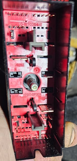

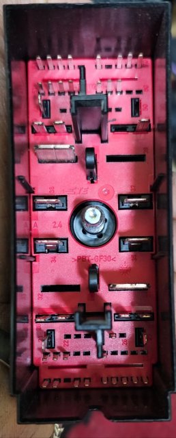

I have brought all the internal electrical wiring along with the operating system code, and I will convert it soon.
Upon reaching this stage, I noticed a difference in the specifications. Do I also need an engine wiring harness, knowing that both models have the same engine, transmission, and air conditioning system? The only difference is that the 2013 model has an automatic rear window control system, while my car has a manual system.
2,067
1,416
The window system uses relays and limit switches - to reverse and handle power - so the command to raise and lower also is provided by the Body Control Module (BCM) thru the switch inputs - so "Manual power windows" should work, the "Auto" in the power window configurations are set by the BCM thru the relays that send power into the door to run the window.
