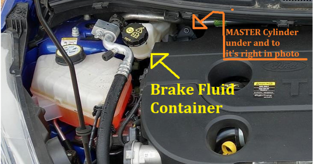

Busted line, low fluid, dirt in line plugging one side - refer to the Master Cylinder - that it houses two cups of fluid and that drawdown hose that goes up to where you fill the fluid.

  • In the USA we have the Petrol version - not the Diesel - so they may call what we would call the "booster" another name, like Accumulator - or power assist. IN either function - if the Assist is constantly engaged, the pushrod that operates from the brake pedal - may not be able to fully retract. If this is the condition - the brake system is starved for fluid. So you need to find out why the pushrod / brake master cylinder is not retracting - to release the brakes fluid pressure back into the reservoir that feeds both halves of the brake system - that heads off to the ABS and the ABS itself has a proportioning system and Traction control using the Wheel speed sensors to handle the braking.
