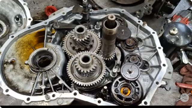

DSP 6 Guts...
Including how the Actuators take place of the clutch pressure plate and it's application of pressure - this case the gearing uses the actuators to not only find the gear using the TCM - but the stepper motors themselves are working in two different events. One in finding the gearing - the other; the pressure in incrementing the gear to apply the force needed to position and engage the gear onto and mesh the teeth of the other gears.

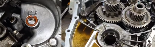

The above photo is from a YT user thinking they had worn a differential bearing - however due to the overall wear of the transmission. Following the owners manual - the lack of fluid changes that let the transmission wear evenly; comes at a cost. Being? Of now the lack of changes for the fluid then lets those suspended particles wear down all components involved which will add a level of slop that now goes beyond tolerance and so you have the "grabbing" issue. This is not just about the moving parts but in the video - it is also shown as a part of the transmission housing CASTING that can limit the service life and require a replacement - so by driving habits as well as the level of torque applied, can drastically shorten the service life of the transmission. Be sure to look for the Magnet the transmission (any of them) comes with. The level of particle suspension in the fluid being ferrous metals - can be attracted to the magnet and stay, but its also the non-ferrous metals and materials used (brass as well as other media like; coatings and aluminum of the casing itself) that add to the contaminate suspended in the fluid - increasing wear.
